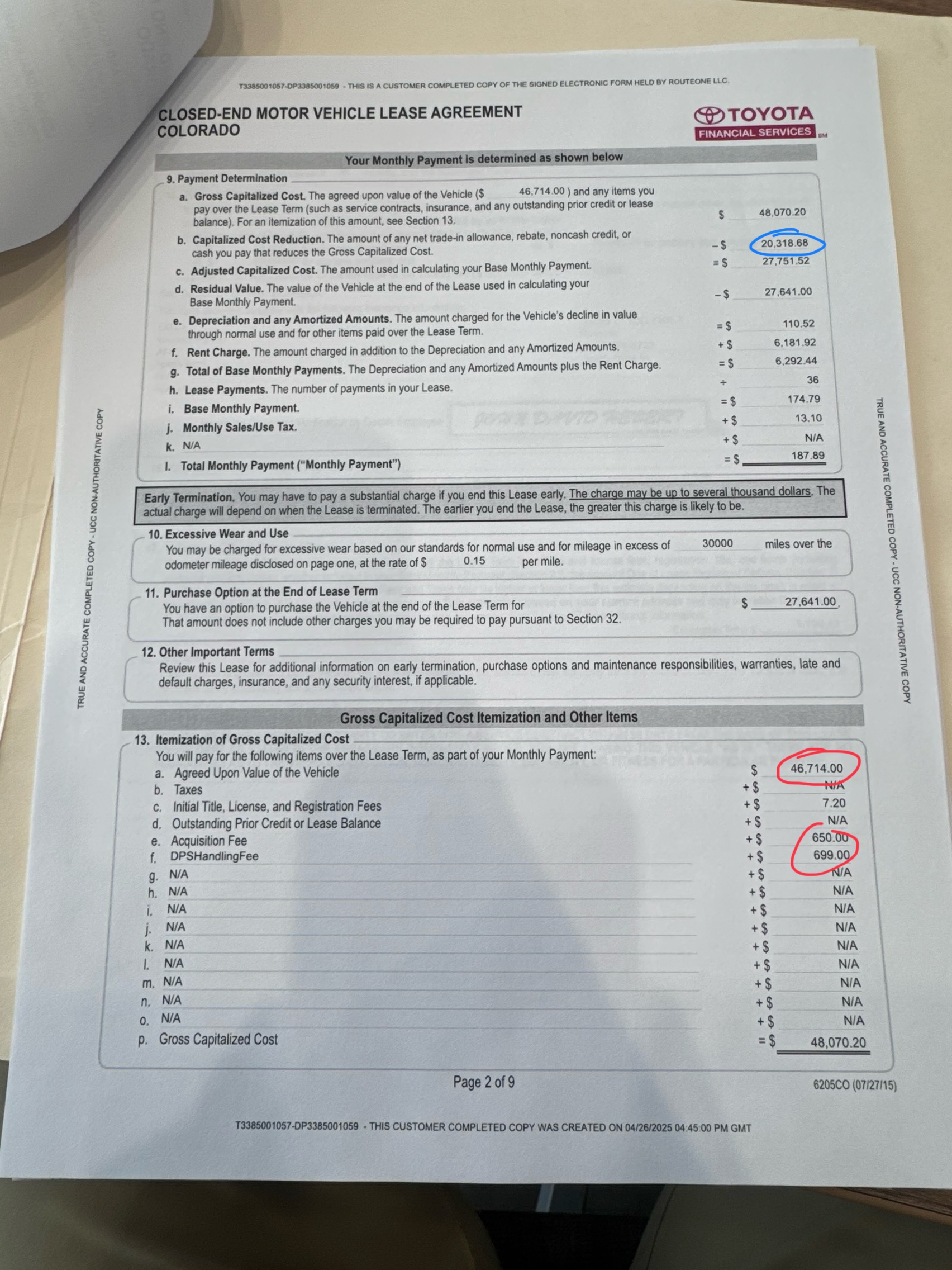

  1. Why are they charging sales tax ($726) on my Cap Cost reduction (trade-in and EV incentive)…see attached lease agreement.
  2. I agreed to pay sticker price, but it looks like they are they are doubling up a bunch of costs on lease agreement already included on window sticker.
  3. Anything else I’m missing?

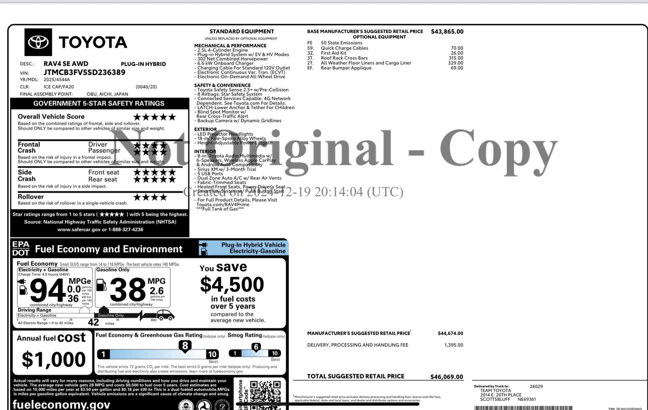

From Window Sticker:
SRP: $43,865
Optional Equipment: $810
(How optional are $400 floor mats and $300 roof rack?)
MSRP: $44, 675
DELIVERY, PROCESS/ HANDLING FEE: $1395
TOTAL SUGGESTED RETAIL PRICE: $46,069.00
The lease shows value of vehicle as: $46,714
and adds on:
$650 Acquisition fee
$699 DPS Handling fee
for a Total of: $48,070

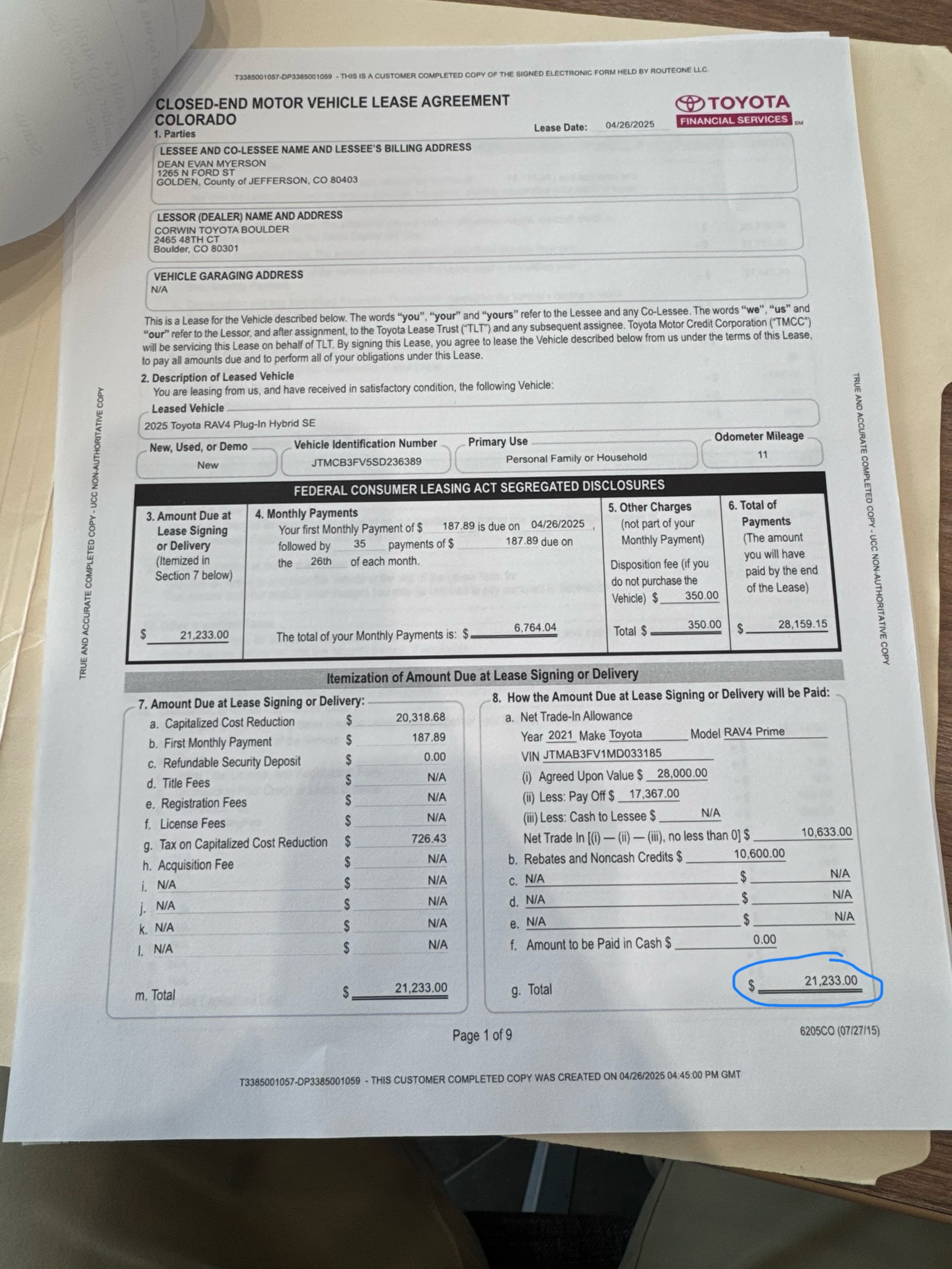

You’ll probably want to redact your personal info on page 2 of the contract.

Your net trade value is not subject to sales tax. What is taxable are any rebates/cash used as a cap reduction (CCR).
Net Trade CCR = 10633.00
Rebate CCR = 9685.68
Total CCR = 20318.68
NOTE: Total rebate = 10600… of this amount, 9685.68 is used as a CCR. The balance of 914.32 is used to cover the upfront charges…
1st payment = 187.89
Rebate CCR Tax = 726.43 … = 7.50% x 9685.68
TOTAL = 914.32
Bottom line: DAS = 0 followed by 35 monthly payments of 187.89 each.
The agreed upon value of 46714.00 is the selling price and so, you’re paying 645 over the total retail price of 46069 and 2040 over MSRP. TFS acquisition fee is 650. The agreement shows DPSHF = 699. The acq fee is not part of the MSRP. The DPSHF likely includes the dealer doc fee. So, DPSHF is not part of the MSRP. You should get some clarity on the DPSHF disclosed in the agreement and the DPSHF disclosed on the sticker.
