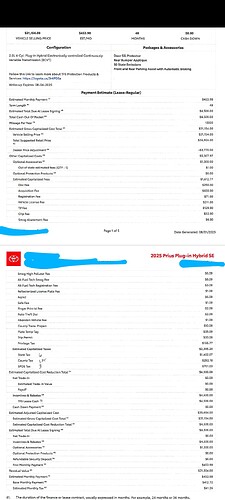

Appreciate all the wisdom here, first time poster tho! Trying to lease a 2025 Prius Plug-In in order to get the $4500 lease cash and then buyout the lease immediately.
Have two offers.

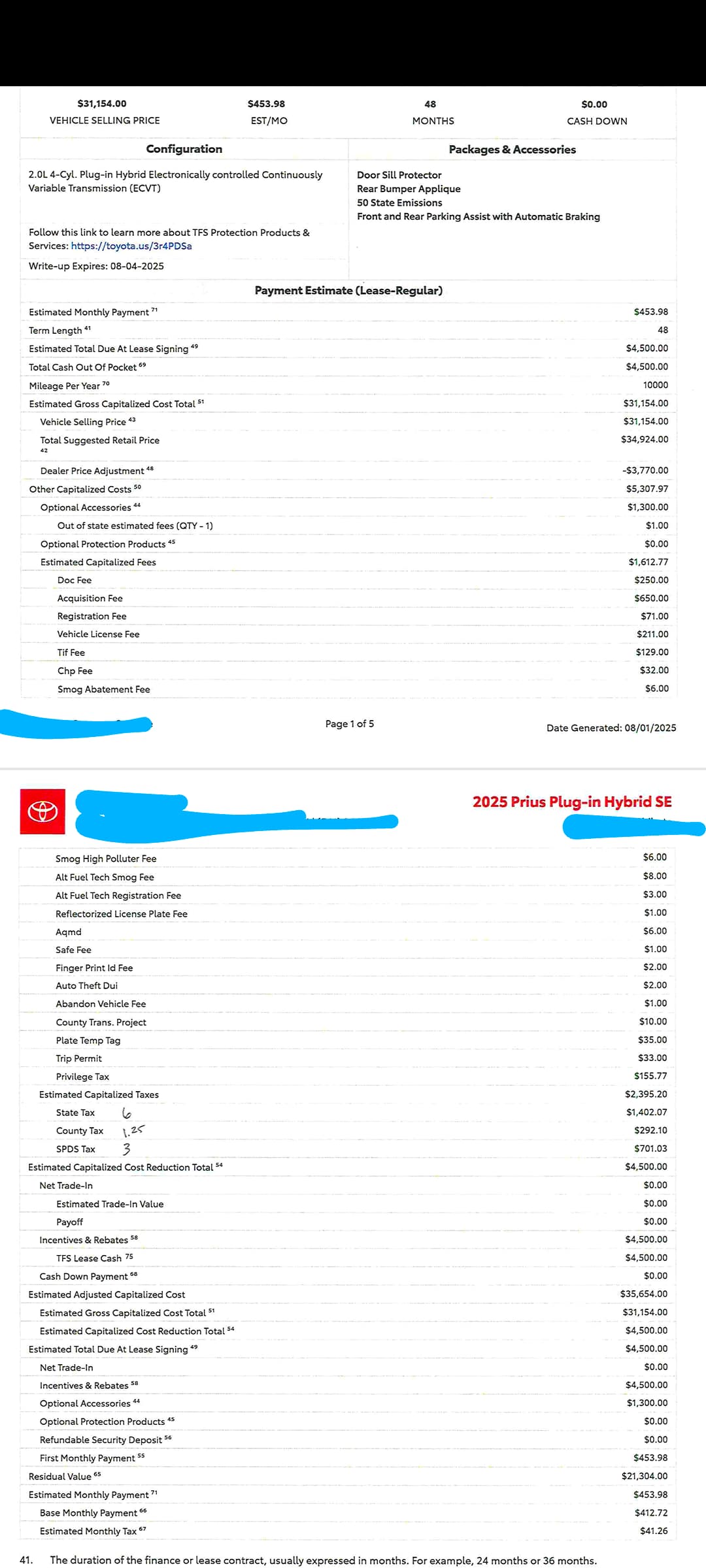

First is from Oregon, which I would have drive back to California. I’m unclear why tax is capitalized if Californians only pay tax on payments. Also, confused by the adjusted cap cost is higher than the gross…
Second is from NorCal. A lot less detail and no mention of taxes.
The formats are totally different and I’m not clear if they’re competitive or if I’m being ripped off (on one or both). Any help would be greatly appreciated!
I don’t think either of these are very competitive. Where is the discount off MSRP? I believe @Jrouleau426 was doing an extra $3k on top of the $4,500 discount recently.
Looks like you are getting a $3700 discount on the first deal and barely anything on the second. What are the $1300 in optional accessories in the first deal?
You will have to pay tax on the incentives (other than what’s applied to untaxed fees), so having some capitalized isn’t surprising. They are definitely calculating tax wrong though.
Thanks for validating my thought on the taxes. 1300 is a BS charge that they apply to anyone purchasing from out of state, which reduces the 3700 discount down to 2400.
