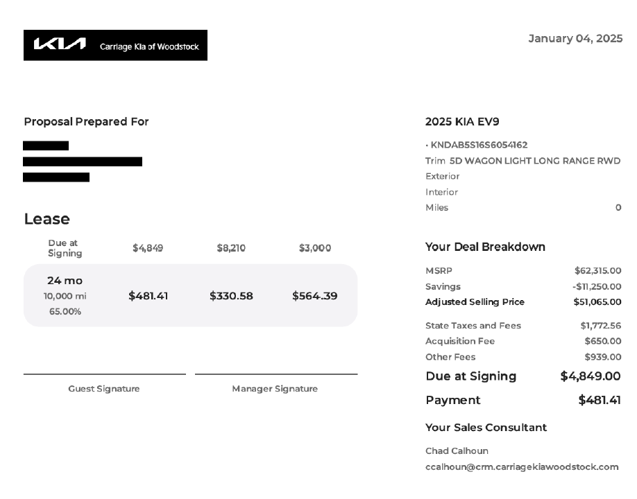

Leasehackr People, thanks for your time in advance. I’ve had issues with Kia Dealerships in GA showing one set of numbers but not knowing all the incentives I qualify for. I have a deal before me, but this has about $4K missing from the nationally advertised Kia Lease Deals. One dealer told me that the Nationally advertised Kia Lease deals are unattainable. Still, after seeing that I can negotiate the MSRP from Leasing 101, I believe that I should be able to get lower than the nationally advertised Kia Lease deals. Here are my stats:
Military Veteran
A1 Credit
Current Tesla Owner ($1.5K upside down)(Thanks, Elon)
I have $5K available
I want a Kia EV9 LLR or Land for less than $350 for LLR and $400 for Land.
I want 12K/24m
Make sure you are getting 9900 kia lease cash, 500 military, and 1500 tesla conquest.
Your quote shows 10k/24 month so should have MF 0.00092 with 65% residual.
Have you run the numbers through the calculator?
Great recommendation. I see that the dealer is not far off from the calculator and my score is 7.7 years.
Post a pic, not a link for a PDF download.
How much of the discount is rebate and how much is % off MSRP?
Good questions. I think that none is % off MSRP. What is the best way to find out the average % of MSRP?
