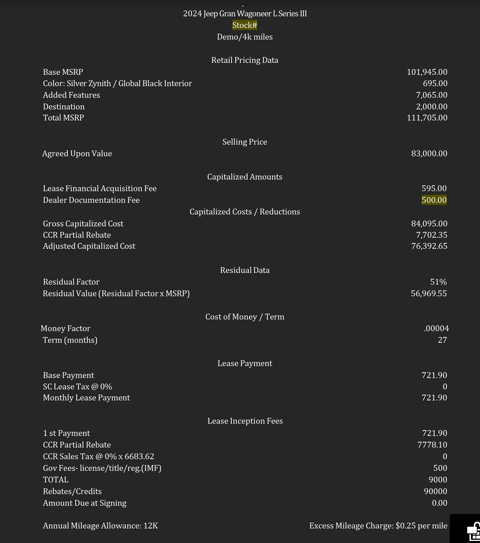

Yep, i bungled it. Take 2!
Your CCR partial rebates do not match. One is 7702.35, the other is 7778.10. I suspect it should be 7778.10 which means your adj. cap should be 76316.90 yielding a base payment of 721.90. Nowhere do I see SC tax.
You are correct. Sorry im transferring over numbers from a spreadsheet on my phone. Its my understanding that there are no taxes in SC, only the IMF. Then each year you pay property tax which is the cost to get a sticker.
I assume that you’ll pay that separately from the lease. If it’s paid with the lease, you’ll need to either cap it or, pay it a lease inception.
