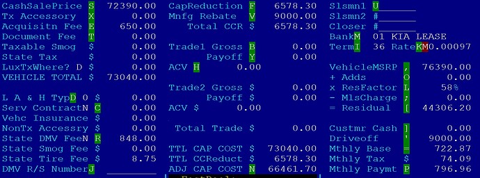

Deal Check EV9 GT Line $4k off MSRP $9k Rebates $796/mth $796DAS
Kia EV9 Socal
GT Line 36/12
$4k off MSRP (shopping around LA, this is the best I could get down.)
$9k Rebates
The MF is correct. The RV is 1% more than what I was told in the forums.
His numbers are correct, but when I plug in the Calc, his total is a little high.
Interested in everyones thoughts
Thanks in advance
Paul
Well, he is using LA county taxes at 10.25 vs your 9.5 (OC?)…still not enough to make up difference tho.
24 month is better programs.
Needs more discount
ah ok.
Thanks for your feedback.
La county is 10.25?
I changed it, but yes. there seems to be around $400 off somewhere.
Overall though, does seem like a decent deal?

His system used 10.25 (either he input your address or they use the highest rate so peeps don’t bitch later). So, depends on your city even within the county…Kia’s system will charge you the correct rate based on your address.
In California, you pay sales tax on the monthly lease payment, not the vehicle’s total value. The tax rate can vary significantly across different cities and counties, ranging from 7.25% to over 10.25%. (I paid 7.75 for car last year for wife in southern OC)
THIS MAY BE OUT OF DATE TOO BUT FYI:
Sales Tax States elaborates, explaining that Los Angeles County has a 9.5 percent sales tax, making this the lowest tax you can pay within the county. However, individual cities within the county can increase this. In downtown Los Angeles, the sales tax is 9.5 percent, but nearby Culver City has a sales tax of 10.25 percent.
figured what it is.
if you change the residual to what it should be 57% and keep the sales tax at 9.5 then it all adds up.
the print out he has that the RV is 58 must be wrong.
