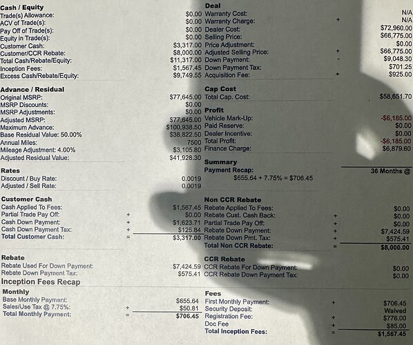

I offered 14% off and buy rate MF (.0019), resulting in $710/month incl. tax + $3,317 DAS (I estimated $199 doc fee and I’m only eligible for $500 military incentive, no loyalty, conquest or fleet). Leasehackr Calculator - Hack your next lease | Leasehackr

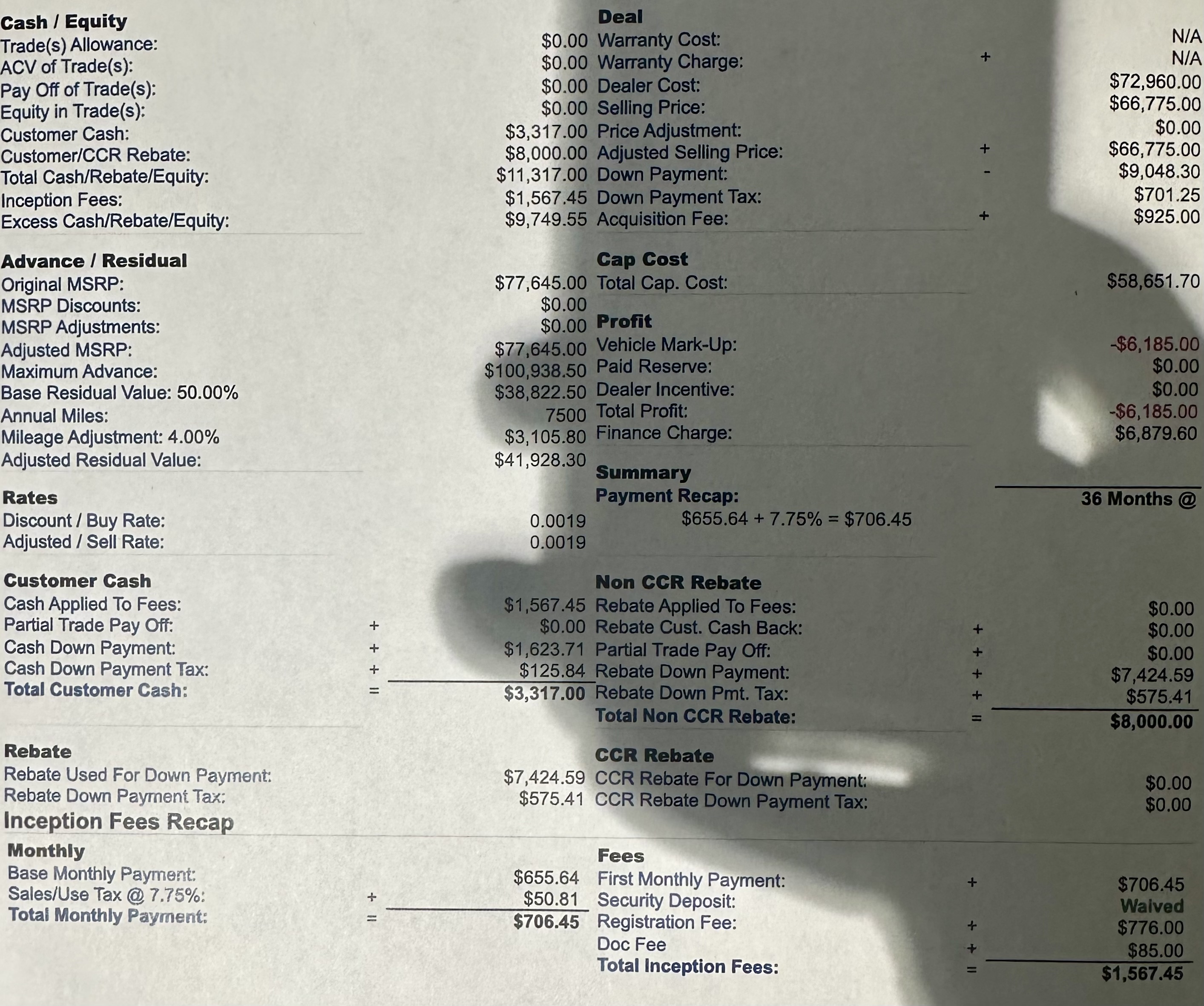

Dealer responded with $706/month incl. tax + $3,317 DAS and said they modeled the deal using my numbers but didn’t have a detailed breakdown for me to review (dealer is impacted by CDK cyber attack). I accepted and Finance struggled for four hours handwriting the docs and basically gave up filling out part of the lease agreement (it was 9:30pm Sunday). They had me sign based on this worksheet and promised a typed copy of the lease agreement later. (It appears their doc fee is only $85 and they moved some cash into down payment).
Two days later, they brought me this typed lease for $660/month incl. tax + $3,317 DAS. I can’t get the math to work out so I’m not sure what they did, but I just signed since it was lower than the original amount. Can anyone make sense of it? If there are errors will BMWFS just reject this?
Everyone is just doing the best they can, don’t stress it if it’s less, but expect they might have you resign a corrected contract eventually.
They messed up the Rent Charge big time. Expect to sign a revised contract.
Yeah, and it shows. That lease agreement is a disgrace. It has a few mistakes…
There is an acg fee = 683.8 on line 9(A)(8) and another Acq fee = 925 on line 13(N).
Gross Cap 67700.00 line 10(A)
Cap Reduct. 9117.25 line 10(B)
Adj Cap 57657.75 line 10(C) should be 58582.75
This inflates the payment. The base payment should be 653.59. The contractual payment should be 653.59 x 1.0775 = 704.24

There is no need to pay anything out of pocket at lease inception if you so choose. You may want to create a target deal, complete a lease proposal, and
email it to the dealer. Then, negotiate via email/phone. Based on the dealer’s lease worksheet (the lease contract is garbage), here is what I have…
Lease inception fees
1st payment 785.12
CCR 6588.40
CCR Tax @775% 510.60
Doc Fee 85.00 (dealer shows no doc fee tax)
Tire Fee 7.00
Gov Fees 776.00
EV Reg. Fee 33.00
TOTAL 8785.12
Rebate Credit 8000.00
DAS 785.12
Payment calculations
MSRP 77645.00
Sell Price 66775.00
Acq Fee 925.00
Gross Cap 67700.00
CCR 6588.40
Adj. Cap 61111.60
Residual 41928.30 (RF = 54%)
Term 36
MF .00190
Total rebates 8000.00
Sales Tax Rate 7.75%
Base Pmt = .00190 (61111.60+41928.30) + (61111.60-41928.30)/36 = 728.65
Contractual Pmt = 728.65 x 1.0775
= 785.12
I don’t advise paying out of pocket money upfront other than the 1st payment. Conserve your cash for other durable goods and services that may outweigh any other savings. A car is a depreciating asset, not an investment. If you total the car, you may not be able to get your front money back. Your call.
do you suggest to roll upfront fees and taxes into monthly payments even with current high MF (interest rate)?
Nope. This is exactly why I’m suggesting that you use a portion of the rebate to pay upfront fees except the acq fee which is typically capitalized. However, this can be paid upfront as well.
Bottom line is DAS = 785.12 plus 35 remaining payments of 785.12 each.

I never heard anything from the dealer so I tried to access my BMW financial account to pay the monthly and it errored out. I called the dealer and it seems the paperwork/lease went into a black hole and was never processed. They had to redo all the paperwork and agreed to meet in between the two payments I had been quoted, which came out to $695/month incl. tax + $3,317 DAS (already paid). This was about $15/month less than the target deal I went in with, so I was happy. They also paid this month’s payment for the hassle of having to sign another lease. I wasn’t sure how to account for that in the calculator, so I put it in post-sales incentives. CALCULATOR | LEASEHACKR
