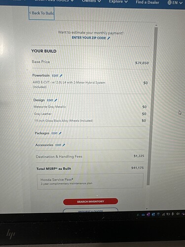

MSRP: $41,855 (includes D&H)
4% off MSRP

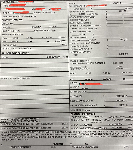

MF: .00247
RV: 66
Terms: 36/10K
Monthly: $465 (taxes rolled in)
DAS: $2,000
I don’t have all the numbers broken down but that’s the deal I finalized after some back and forth on the phone.

So is this deal $6,000 DAS instead of $2,000 in reality?

Their value for your 2021 Accord seems too low

Do you have some paperwork showing how the dealership got to sale from MSRP price? Just going by pmt is not a straight forward process since they can hide in there so many things
Shows the same price on Honda National site.
