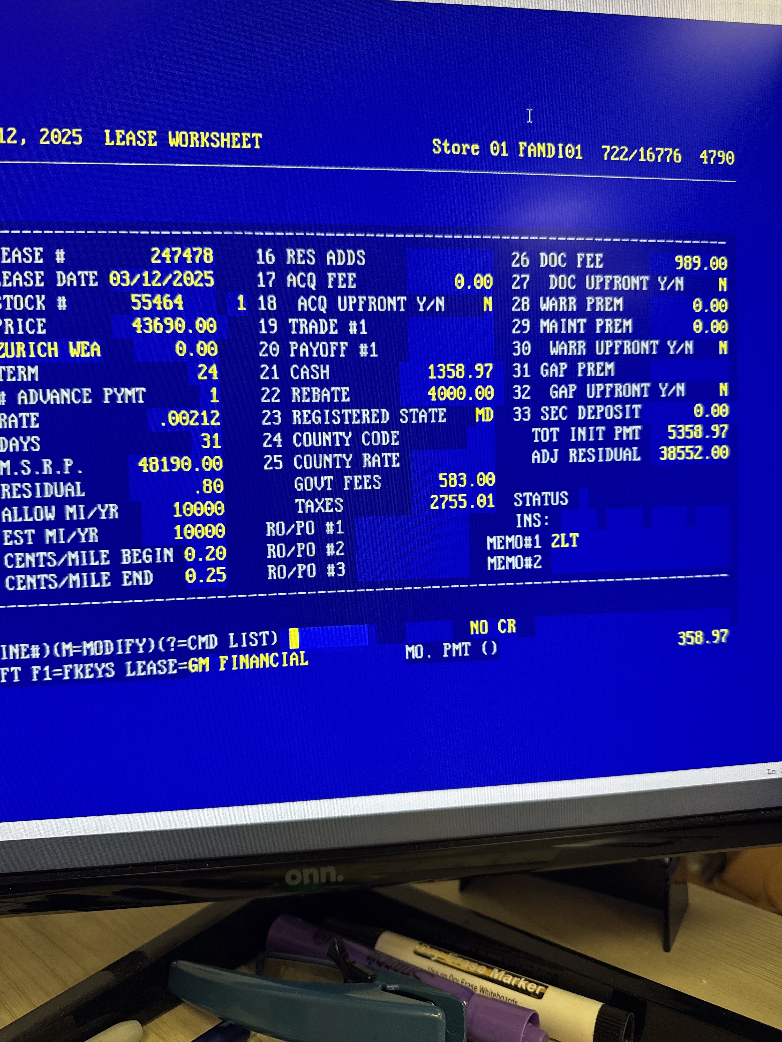

Seeking advice on where I could potentially capture some additional savings. I’ve seen dealer discounts on 2025 LTs as high as 13.75% off MSRP but not sure how I can achieve a discount in that range, so would love to hear any guidance on that. Also not happy about 989 doc fee (virginia) but expecting them to hold firm on it. This is my first lease and still learning.
MSRP - 48,190 (convenience package II - 11,400, sunroof - 1,500, charge cord - 295)
Dealer discount - 4,500 (9.34% discount off MSRP)
Chevy incentive - 4,000 total (chevy incremental ccr 1,750, costco executive 1,250, healthcare 500, gm card 500)
Lease term - 24 months / 10,000 miles per year
Residual - 80% - 38,552
MF - .00212083 - 5.09%
Acq fee - 0 - Waived by Chevy
Down payment - 1,000 (to get the gm card bonus)
Monthly - 352
Due at signing - 1,352
I believe the numbers in the screenshot are incorrect for maryland state excise tax (6%) and maybe also government fees. Anyone from maryland please chime in. My calc (see below) shows 352 monthly.
This dealer is in virginia, so no cap on doc fee (they charge $989). The cap on doc fees in maryland is $800 (though some dealers in md still charge $500).

You may want to determine how MD computes taxes. I do know that tax is levied on the sell price and there may be some sort of tiered rate structure. Not sure how they arrive at 2755.01 tax… effective tax rate = 2755.01/43690 = 6.305814%. Also, the 583 gov fee likely includes title/reg./license fees. Your LH calc shows 493 and your money factor of .00212083 is invalid. MF’s are of the form .00XXX. It should be .00212 according to the dealer WS.
I’m not a fact of online calculators preferring, instead, to perform my own calculations. I manually confirmed the dealer’s calculations, and they are accurate. I’ll reserve comment on the taxes as I’m not sure how MD computes them. Check with the MD Dept. of Revenue- Sales Tax Division.
Sell price 43690.00
Capitalized fees
Doc Fee 989.00
Gov. Fees 583.00
Tax 2755.01
Gross Cap 48017.01
CCR’s
Rebates 4000.00
Down payment 1000.00
Adjusted Cap Cost 43017.01
RV 38552.00 = 80% x 48190.00
MF .00212
Term 24
Payment = .00212 x (43017.01 + 38552.00) + (43017.01 - 38552.00) / 24
= 358.97
Bottom line: DAS = 1358.97 following by 23 monthly payments of 358.97 each.
