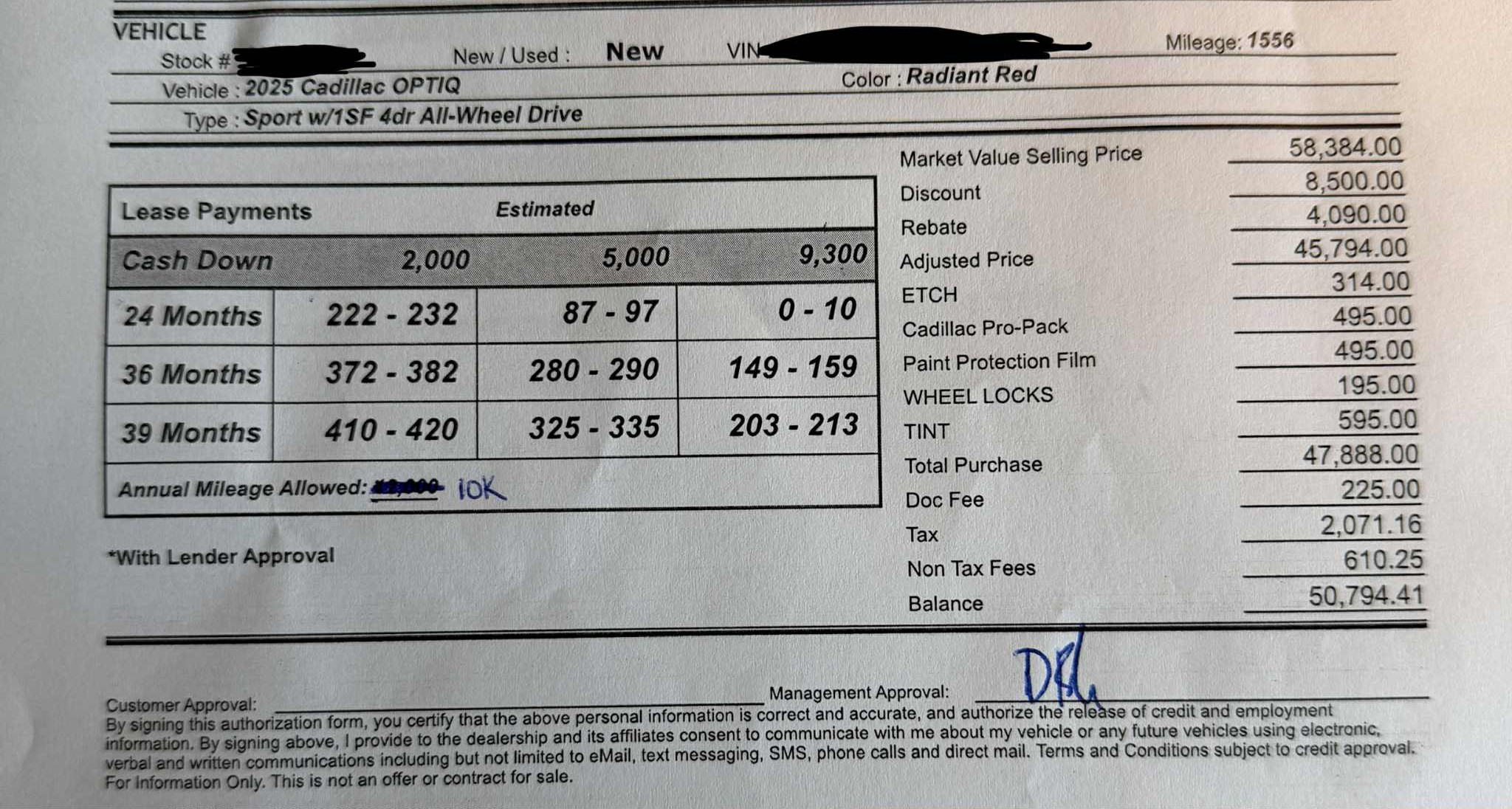

Working a 2025 Optiq Loaner. 24 months, 10,000 miles a year.
I only have conquest and costco executive. (No GM Supplier unfortunately)
Here’s where I’ve negotiated to.
$2,000 DAS drive off including TTL & First month payment (I asked twice to the manager to confirm), Pic says $222 a month, but as I was leaving the dealership, the salesman chased me down and said they could do $200 a month. $2000 DAS + $200/month = $283/month effective.
This is before $500 GM Card, as that I’m still debating if worth a hard pull on my credit.
Residual $47,039
Money Factor - 0.00145
There’s still a bunch of dealer add ons, totaling $2,094 (ETCH, Cadillac Pro-Pack, Paint Protection Film, Wheel Locks, Tint) which makes me think I can get lower.
Should I shoot for $1,000 DAS or even $500 with $200 a month? They claim those dealer add ons are already on the vehicle and have to charge it. They did lower it, they had $1,995 each for Cadillac Pro-Pack and Paint Protection initially and brought it down to $495 each.
My attempt at calculator: Leasehackr Calculator - Hack your next lease | Leasehackr
Good lord, even with all those add ons they still have you at 11% off which I’m fairly sure is incredible on this car. That’s before they lowered it further to hit $200/month with $2,000 DAS. If I were you I’d be signing tonight.

Rough math says you’re at 6600 for the lease term, without using Supplier or GM Card. Those are very strong numbers. For reference, in CA, I was at 5984 on a similar term but with $500 from GM Card and $1000 from GM Supplier.

Ask for the one pay lease amount. You can save about $50 a month.

Don’t get greedy. We’re now in October and dealers only have a limited number of vehicles they can apply the higher residual to. Also why aren’t you doing a one pay.

That’s a pretty good deal, especially without a lot of the incentives available in previous months. Like others mentioned, I’d ask for onepay. I think you can get $6K onepay.

Got the manager to bring it down a little more with one pay and will be signing tomorrow morning, from $6,600 ($2,000 DAS + $200/month) to $6,300 One Pay. I’m trying t see if they can get the $500 for the GM Card snafu fixed to get it to $5,800 or $241/month effective
Then shoutout to @baoknguyen for enlightening me about the TCEQ EV Rebate. If that goes through, it knocks off another $1666 to $4,134 or $172/monthly effective!
