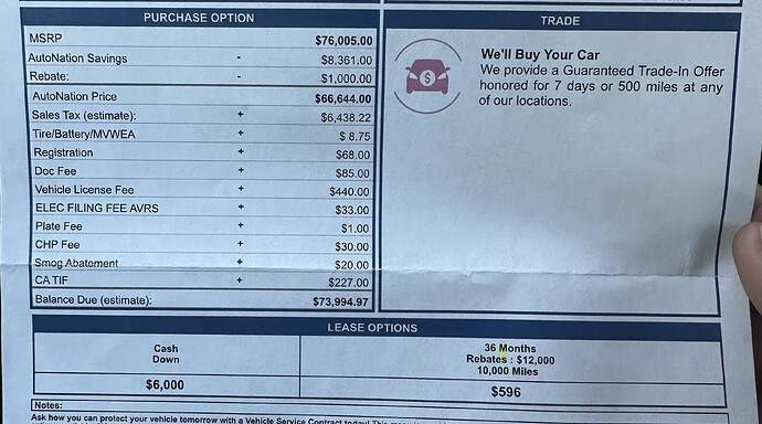

Got an offer on a 2024 Core model for $596/mo with 6K down. Unfortunately the dealer was a little cagey and didn’t give me RV, MF, etc etc just this deal sheet telling me they would go over all the numbers when i brought the XC60 in and was “ready to do the deal”.
I tried to reverse engineer it with ratefindr on the calculator, this is what I came up with, MF looks high from RF but shrug
'24 XC90 deal sheet 1

Per the Rate Finder, I plugged in a Sacremento zip code, and you should be getting the $7500.00 EV credit and a $3500 Lease Allowance before you even negotiate anything off the price. If you have a FWD volvo, there is a $1000 loyalty. The MF is hurting you this month at .0035 (equivalent to 8.4%). No one on this forum ever recommends putting money down other than the required tax, title, first month, because if you get into a wreck, you lose all of that equity. Also, it is easier to negotiate with multiple dealers if you simply state that you want nothing down other than the standard inceptions (usually around $2k). If you take out that down payment from the calculator, you’ll see its not that great of a deal - you’ll be paying about $785/mo for the Core model - not even the Plus. Given the high MF, you may be best to wait until September to see what deals are offered.

They told me the $7500 + $3500 + $1000 loyalty is factored in the “rebates” portion which lists $12K in rebates above the monthly quote.

The taxes on this TX are listed at >$6K, so is my “cash down” being applied there or against the purchase price?
Guess I could use some education on what the minimum “required tax, title, first month” should look like (is this the “around $2K” you mention as standard inceptions?)

The sales tax on this doesn’t make sense for CA. Is this a quote that shows leasing and finance options on one page? I think they are showing the taxes/fees for a purchase and not a lease. Also, they aren’t showing the Lease Acquisition fee which makes me certain the calculations aren’t for a lease.
Yep, I followed up with the sales rep about this and residual value. Reply was “the breakdown always shows everything included, you will only pay the full sales tax if you decide to buy out your lease”
I’ve gotten a few deal sheets this week from other stores and they look like lease deal sheets. This one is the only odd one, I assume it’s just a dealer/manager idiosyncrasy. I asked them to provide the missing info. They did clarify that the $596 is all in including taxes.

Maybe this is a dumb question but if there are $12k in rebates why is the cap cost reduction only $14k? I thought the $12K rebates + $4k cash would make the cap reduction $16k?
Sales tax and Acquisition fee (And DMV, etc) are subtracted. That’s why it isn’t an Even 14k
