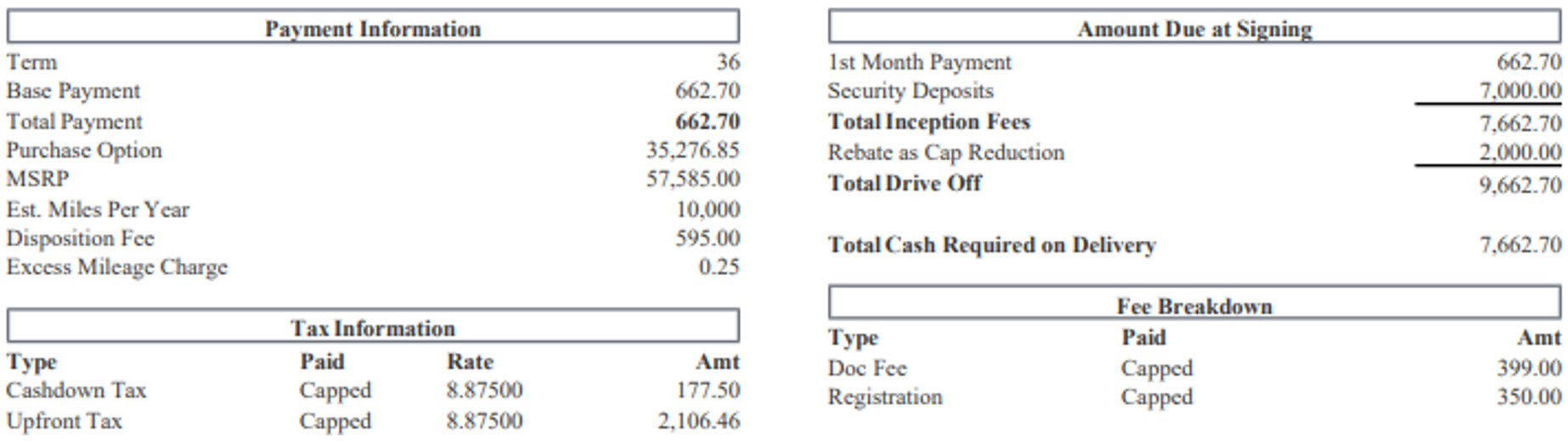

Hoping to get a POV on a deal for a '24 MB C300/4M that I am considering.
I asked for 11% off MSRP (pre-incentive) + incentives/rebates ($2k in loyalty + $500 fleet), max MSD’s, 36/10, first month DAS.
Here’s what the dealer came back with:
I’m about $10 off on the LH calc. I’m assuming that’s b/c the calc doesn’t factor in the first month payment? (Am I correct?)
They didn’t share the actual selling price or the MF, and the residual value is off by a small amount. Was hoping to reverse engineer the calc to figure those things out so when I go back to the dealer I’m in an informed position.
Based on what I’ve seen, I think this is a good deal. But just want to make sure that I’m getting what I asked for.

Ok, I received more information from the dealer, which makes this all the more confusing to me…
MSRP: $57,585
Selling Price: $52,500 (8.83%)
Loyalty: $2k
Fleet: $500
Final Selling Price: $50,000
Residual: 61%
Residual Value: $35,276
Max MSDs
MF: .00161
First Month DAS
Monthly: $662
With the exception of the pre-incentive discount (I asked for 11%), the numbers check out. But when I plug these numbers into the LH Calc I’m getting a much higher monthly (by $30). What am I missing/doing wrong?

I’m still baffled by the $30 difference between the LH numbers ($694/mo) and the dealers numbers ($662/mo). Any thoughts on what I might be doing wrong?
Few things:
  1. Your RV is about $150 less
  2. $0 DAS means sign and drive, not first month due at signing.
  3. $2500 incentives seems like its untaxed.
I got the calculator to match exactly if the above three are adjusted. The main issue was first month due at signing vs $0 due at signing (which is what your calc had).
