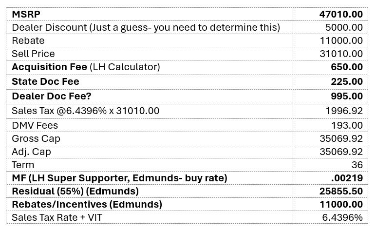

You’re allowing the dealer to control the deal. Please excuse my long-winded dissertation but I think what follows is very important and can help you IMO.
Please don’t waste time trying to decipher a dealer’s worksheet or chasing after them. Otherwise, you’re allowing them to control the deal. They often omit a lot of relevant detail such as money factor, monthly base payment, monthly contractual payment, fees not itemized, etc. You need to rely on credible outside sources (e.g., LH marketplace and signed deals, Edmunds, etc.). Do your own research and establish a reasonable selling price in your market. Be sure to get a copy of the factory window sticker. Check for non-factory add-ons or dealer-installed options. And, if possible, eliminate those you don’t need or want. Get a list of all customer and dealer rebates/incentives including VIN#-specific discounts/incentives, if any. And, yes, the dealer has such a list.
The only thing useful about dealer lease worksheets is the input data (bolded below). All data should be vetted such as acquisition fee, doc fee (regulated by some states), cost of money (e.g., money factor), gov fees, residual, rebates/incentives, sales tax rate, etc. Make sure the residual matches the term and annual mileage requirement. Organize all relevant data in tabular format like those below with the goal of creating a lease proposal that reflects your target deal. The idea is to create your own target deal (proposal), not replicate the dealer’s deal.
Next, perform monthly payment calculations like those shown below.
Contractual Pay = .00219 x (35069.92 + 25855.50) + (35069.92 - 25855.50)/36 = 389.38
All fees, including taxes, are capitalized. See my LH calc.
Bottom line: 389.38 drive-off fees followed by 35 monthly payments of 389.38 each.
