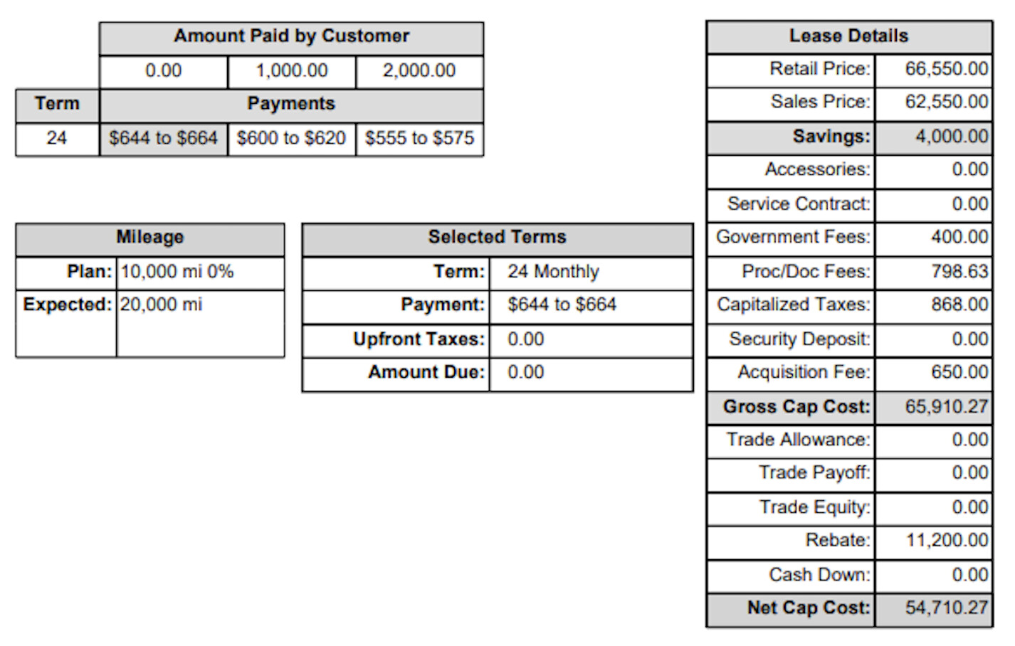

Hey all. I’m looking to do a two year lease on a Kia EV9. I entered the deal into the CALCULATOR | LEASEHACKR but the numbers aren’t matching what I’m getting from the dealer and I can’t figure out why.

They told me 0.00095 and 64% residual.
Then they have some explaining to do. Dealing with this in text is going to be murderous… it’s almost like you need a zoom call with the sales person lol.
First step, They’re burying $643 of some mystery fee in your lease. Do the math: $62,550+ $400 + $798 + $868 + $650 = $65,266.63.
But they put $65,910.27 as the gross cap cost. This lease says nothing about being a sign-and-drive 23 payments vs 24. But that’s how they structured it. For my sanity, let’s pretend we’re dealing with a normal 24 month lease where first month payment is due at signing and that’s it.
So second step, let’s take sales tax out of discussion for now. Figure out the pre-tax # first then add in sales tax.
The MSRP is $66,550 with 64% resid that is: $42,592.
The Pre-Tax adjusted cap cost is $53,199
($65,266.63 less $868 and less the $11,200 rebate)

Here’s the LH Calculator for $533 a month. Zero down payment. All inceptions capitalized. No hidden $643 as if it were a sign-and-drive. 24 total monthly payments.
Get your dealer to align on this before you add in tax.

But a few of ELead quotes I’ve helped people with look like @mike817 's where the sum total of the itemized costs do not add up to the gross cap cost and it’s up to the lessee to figure out what type of aftermarket or hidden fee gets snaked in there.
Like one DM thread I’m in, the dealer didn’t even itemize. The dealer just flat lied and had a ~$2k fee buried in the lease structure that was never discussed. basically the dealer was offering a $39k sales price that was in reality $41k, but they wanted to show $39k so they just hid $2k in the structure.
It feels awfully shady AF.
Theyre capitalizing the first month payment to make it $0 due at signing it looks like.
The selected terms box does say $0 due, which would be consistent with it being a sign and drive.
I get the calculator to the $0 down deal sheet numbers by capitalizing all up-front costs and marking up the MF by around 0.5%
