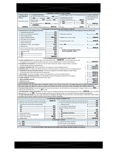

Attaching the lease in case that helps. Again the LH Calc and the dealer’s numbers are about $900 off (not a huge deal in the grand scheme of things), but would be good to know what’s going on here.

A little confused. Your post says GA but from your contract it looks like you have a CA doc fee but without CA registration/title fees. Also shows 7% tax (correct for GA) but paid monthly? CA dealer? registering in GA? Can you tell us a little more about the deal?
Yes, exactly it. Purchasing in CA. Registering in GA. I’m opting for one one pay (for the 1% RV boost), so paying the lump sum up front.

Although I’m still happy with this deal, the more I look at it the more I’m thinking I should walk away. The dealer didn’t apply any of the rebate to cap cost reduction. Is that normal? I’ve looked at several other contracts posted here and most of them show the incentives going to reducing the cap cost. Any thoughts on this and/or suggestions?

They applied the Rebates toward the total one pay cost of 49,816.32 thats why you only have to come up with 12,400 out of pocket. Sec A Item 4.
If the rebates have been applied to CAP Cost Reduction you would have to pay taxes on those Rebates Sec A Item 2.

Gotcha. In my state I’d only need to pay sum of the depreciation over the term and I don’t think incentives aren’t taxed; cap cost reductions are though so this may all be moot in the end. Good info here as I may be stressing over nothing. Thanks.
