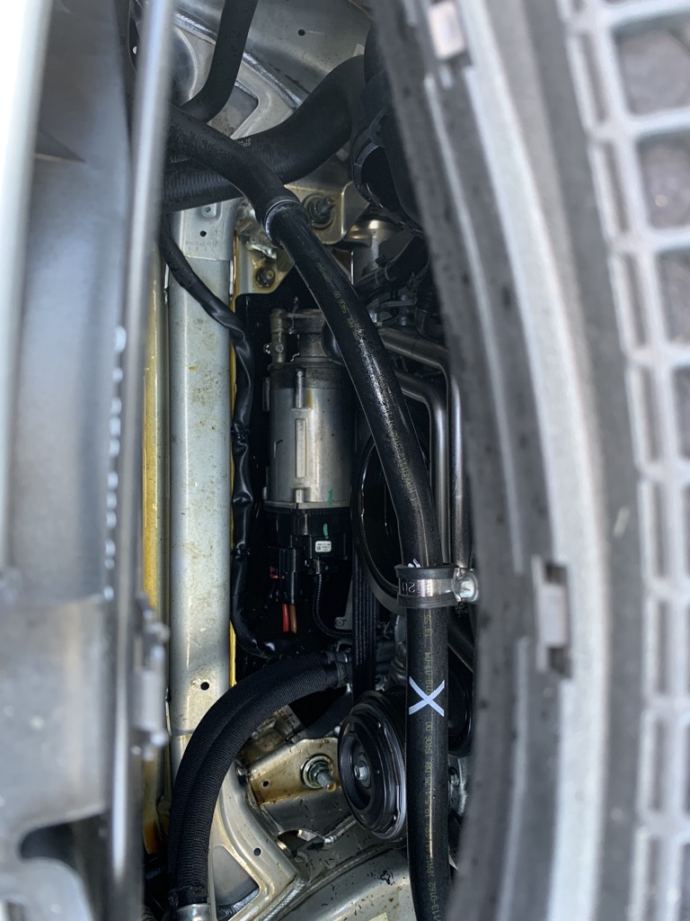

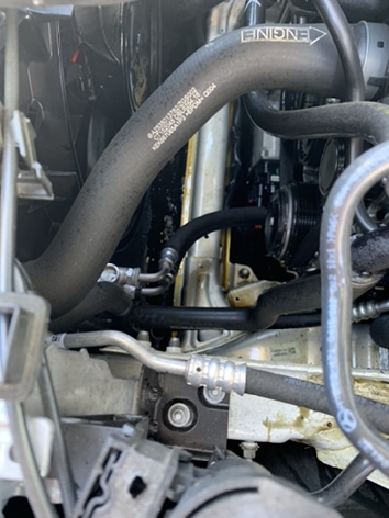

I leased my Mercedes GLC300 last Jul. And the car was good until I sent it to get the first 10K service done at one of the local MB dealerships two days ago. On the way to work yesterday, there was white smoke from the engine if my car. And we found oil leaked out with pressure all over the engine compartment.
I contacted the dealership right away and had MB roadside assistance towed my car there. Today they contacted me that the seal of the new oil filter they put in there was broken. That’s why oil was leaking with pressure. They’ve replaced the oil filter with a new one and steam cleaned the engine compartment of my car. They basically admitted that it’s their fault (either a faulty part or human error) that caused all the issues.

Below are some photo of the oil leak situation.

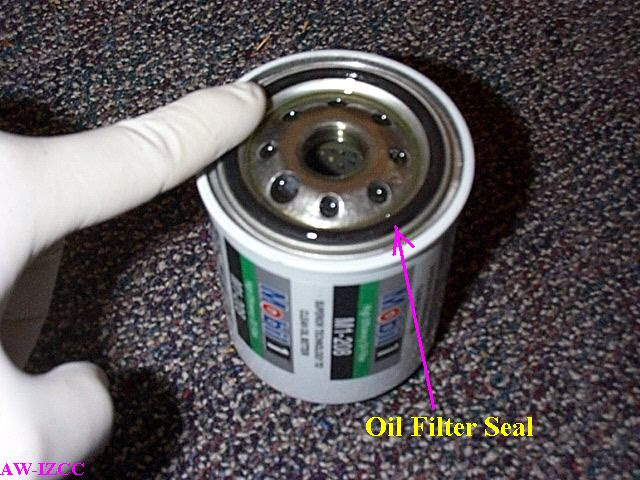

@Yanglin there’s nothing really bad here. Oil filters have rubber O-rings in them (like a gasket) to allow them to seal well to the engine. What likely happened is the O-ring was not seated all the way, or maybe somewhat twisted / pinched and the oil filter didn’t make a perfect seal. Once you started driving and the engine heated up (creating pressure in the oil system) and oil started to push past the wrinkled / pinched part of the O-ring causing the leak. You obviously notice the leak quickly, and you didn’t continue to drive the car w/ a low oil condition, where the engine could seize.
There should be no consequence moving forward, its sounds like the dealership cleaned the engine compartment of oil, and as others have suggested, maybe you can get some future service for free.
You have no position to ask them to return the lease or ask for a new car. Sh!t happens, and you realized quickly, so have peace of mind there’s nothing wrong w/ your MB moving forward.
