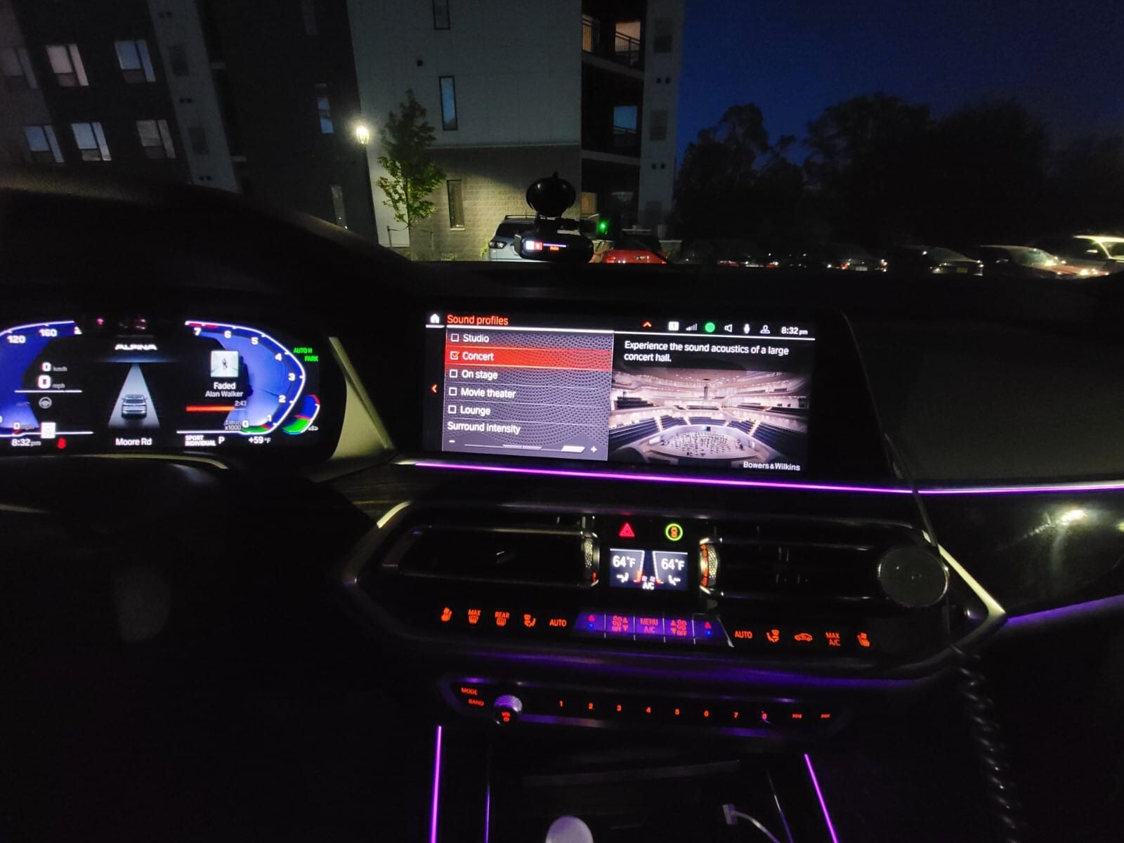

Post Update Pics:
(I don’t think the volume controls showed the B&W speaker pattern before?)
EQ Settings:

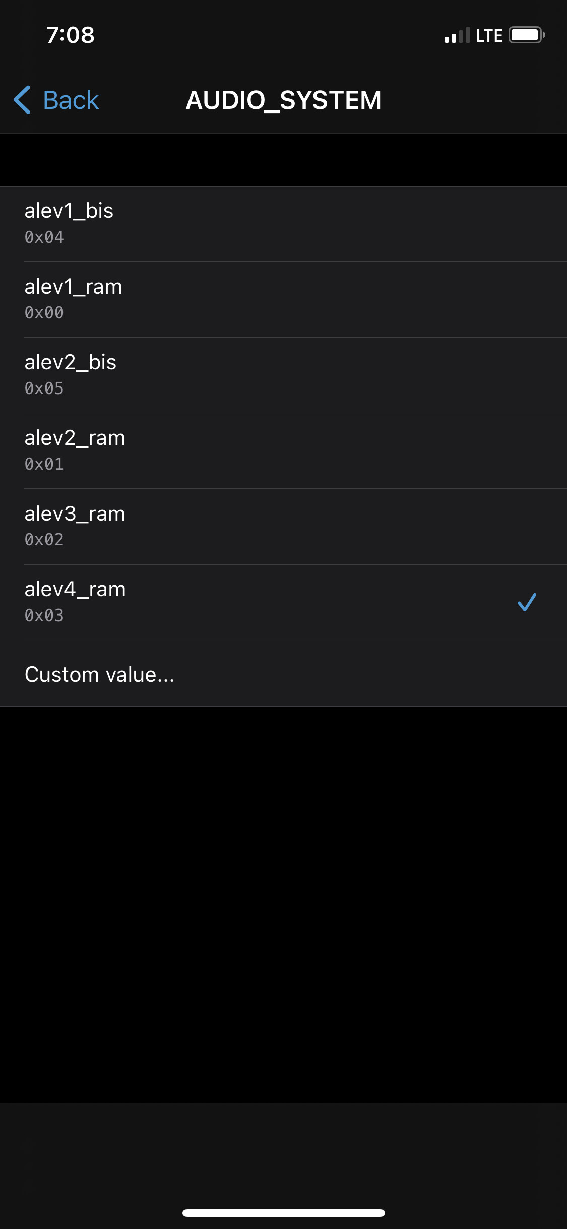

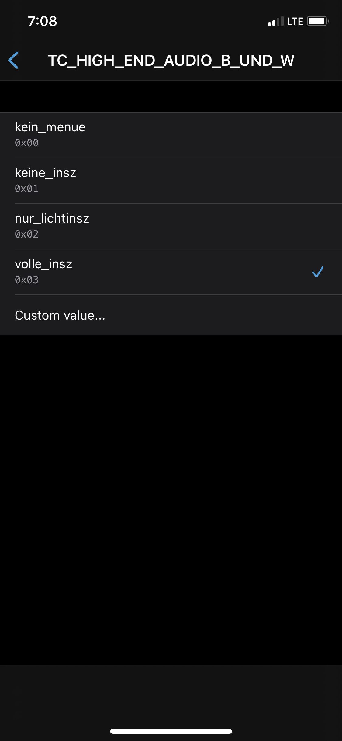

Bimmercode Update Parameters (all accessible in expert mode under HU_MGU):
Hi-Fi → HK Equalizer coding settings (untested):
HU_NBT_EVO > AUDIO_TUNER_TRAFFIC 3002 > AMPLIFIER_VARIANT = most
HU_NBT_EVO > AUDIO_TUNER_TRAFFIC 3002 > AUDIO_SYSTEM = hk_surroundsound
HU_NBT_EVO > AUDIO_TUNER_TRAFFIC 3002 > AUDIO_SYSTEM_VAR = variant1 [Default]
HU_NBT_EVO > AUDIO_TUNER_TRAFFIC 3002 > EQ_VARIANT = variant5
HU_NBT_EVO > AUDIO_TUNER_TRAFFIC 3002 > MULTICHANNEL = nicht_aktiv [Default]
HU_NBT_EVO > HMI 3000 > LOGIC7_SYMBOL = aktiv
HU_NBT_EVO > SYSTEM_EINSTELLUNGEN 3004 > EXTERNER_MOST = aktiv

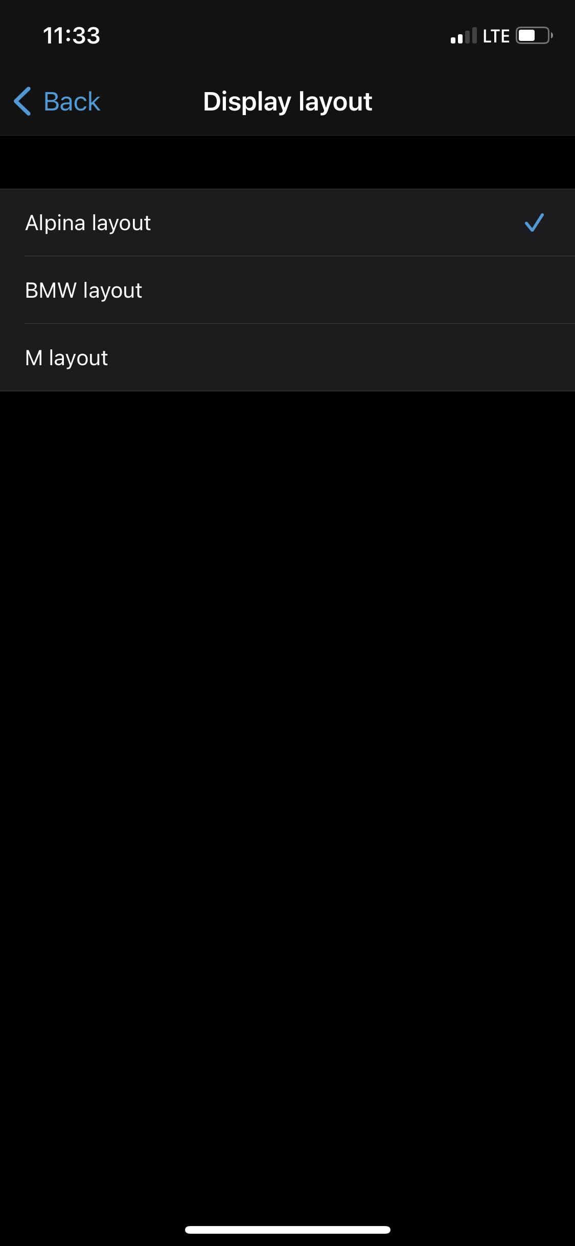

I just really like the Alpina cluster colors/theme, so I’ve enabled that via Bimmercode (don’t need expert mode for this one - relatively innocuous update). Another option is the M cluster, but that has some text alignment issues at the moment.
I can add some screenshots on that later as well, since it’s a quick change that has a pretty big impact.
Quick little bit on updating your dash cluster layout (note that this affects your HUD layout/theme as well):
The DKOMBI4 panel:
Cluster options:
M layout (note the off-center nav text at the bottom that I was referring to)
Next up, trying to figure out how to override the brightness settings for the cluster via esys… given up on finding the control in Bimmercode. :frowning:
