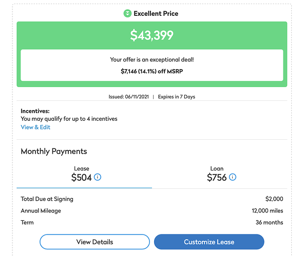

What’s confusing is this. The email they sent me would be approximately this deal, which is almost 11% off MSRP:
But when I click through the email to look at the offer on the company perk site, it shows a lower purchase price, over 14% off MSRP:
I know I didn’t totally bullseye the deal in the calculator but it’s close enough for my purposes. Also I spoke with the salesman and he said the expiry date isn’t actually an issue. A guy at work who chatted with me about this seems to think the worse deal is the actual cost. But isn’t the 43k price closer to what I’d actually be paying? Is there something about this deal that’s illusory?

My guess is that deal includes the 4 listed incentives that you may or may not qualify for.
Good point. But when I click on it on the deals page, none of them are checked. I went in and checked the top two and sure enough it dumped the price down to ~41, so I think those four incentives aren’t factored in.
I’m pretty sure the 1500 is the corporate perk, essentially. So that would be through TrueCar. But, then again, in a year’s time, I might be able to layer that on top of an even larger negotiated reduced price, so maybe this is attractive but it could be better after the chip shortage.

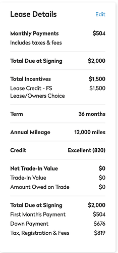

Okay, that’s great. Thank you. I rejiggered the calculator values and now it looks like this (with the email price as the seller price excluding incentives and the incentives below. )
It looks like there’s a down payment. I’m having trouble exactly lining up with their numbers but it’s fairly close. If I cared about every single nickel I’d stay in my Accord another 5 years. Their quoted 10.8% actually showing as 10.76%. Removing the down payment hikes the monthly up to 536/mo. So this seems… fine, but probably not a blockbuster. Still, I haven’t attempted to reduce the cap cost yet… this is just their initial offer. So it’s entirely possible I can counter and get more off the car. What do you think would be a fair target deal?
Hmm… I kind of fudged the fees at the bottom so that it matches their breakdown on the site, then adjusted the MF and got to their monthly number. So my guess is the MF is sliiiiightly up. .00098 instead of .00093.
Couple things on the calc.
  1. $1500 should be in taxed incentives. Also general lease cash on the 330i is $1500 right now, everyone gets that. Corporate fleet on the 300i is $500 right now (I’m not sure if this is the perk you’re referring to).
  2. Gov fees are still the default.
    this site will allow you to get more accurate fees: Registration Fees - California DMV
Bmw dealers almost always mark up in multiples of .0001. Usually .0002 or .0004. It’s unlikely they’ve marked it up by .00005.
Sure, this is a fudge job to be certain.
OK, so I wonder if the employee discount is messing with me. If everyone gets 1500, then where is the Passport/TrueCar incentive being factored in? I think this added element is screwing up my ability to calculate this deal using the normal systems. I’m going to call Passport tomorrow and find out what I need to know about evaluating deals and how their perk gets applied. Better to talk to them than the dealership of course.
Its possible this special incentive is just a pre-negotiated dealer discount, rather than a standalone incentive like lease cash ($1500), loyalty/corporate fleet ($500), penfed ($500), OL ($500-$1000), etc.
This is most likely the case. That was how my older employer that got a true car discount was.
Just dug the information out and you’re right. It’s a replacement for negotiation. So, assuming this deal is locked in stone (unless maybe I adjust the mileage down to 10k) does this feel like a pass to you?
