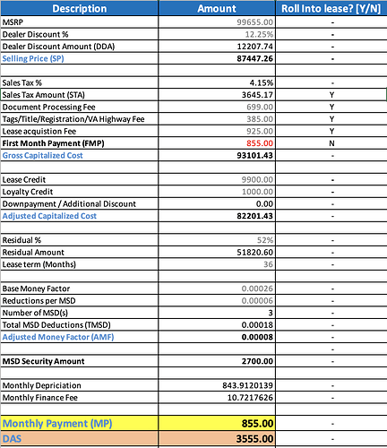

Thank you @boozinix for the reply. $960 is true zero drive off lease. No add on - breakdown (attached). I am still negotiating with the dealers, but so far based on 4-5 dealers I reached out seems like 12% discount is the max.

Thanks everyone for all the valuable tips and guidance! I am happy to share that I have successfully closed the deal. Here are the details:
MSRP: $99,655
Discount: 12.25%
MF: 0.00008 (0.00026 - 3 MSDs)
36 months / 12k miles
Monthly payment: $855
Due at signing: $3,555 (includes $2,700 MSD + $855 first month)
