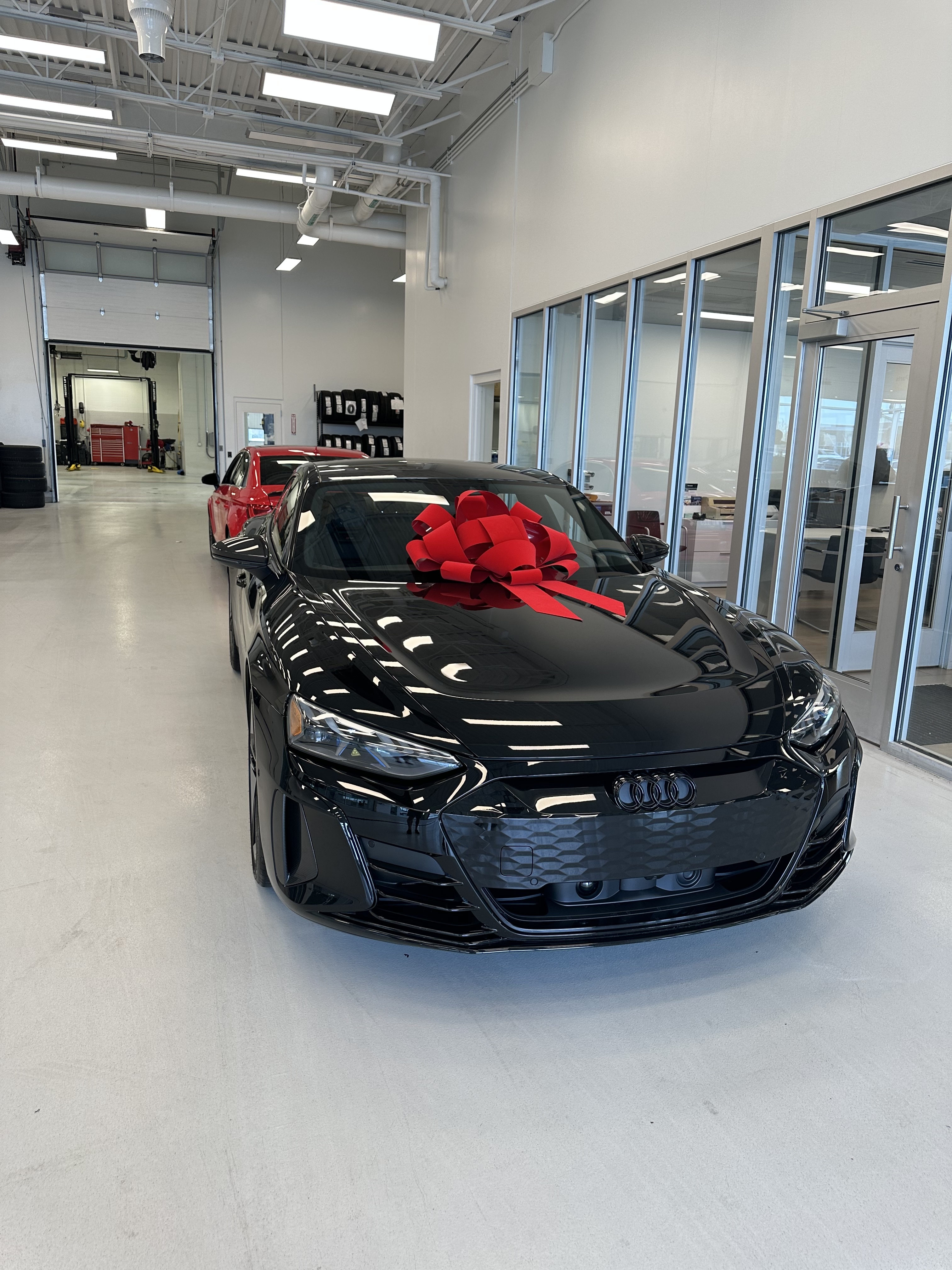

The local dealer Audi service advisor is one bad motherf’ing lady and she took it upon herself to 1) get the vehicle to her shop ASAP 2) get on the phone with her Audi rep and make sure I was taken care of and get my car to be in the condition it was supposed to be in.
Once it got to the service center, the technician spent 2 hrs just to get access to the 12v battery to charge it. They identified some minor damages which will be fixed as a resulting of the winching/extraction and I’ll take it back when parts have arrived. She also got approval for a full detail of my car cuz she felt it wasn’t clean enough for new car and even put a bow on it to give me a new new car feel given my experience!
I have driven the car for 100 miles now since I got it yesterday and it is a f^%#ing absolute blast and it’s insanely fast. My kids love it and my wife likes it too!
