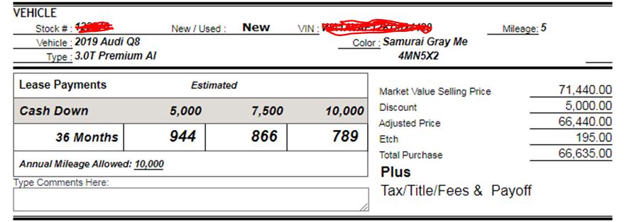

Trying to understand what I’m doing wrong or missing or what the dealer angle is. In North NJ, MF = .00195, RV = 57%
Leasehackr:
Dealer:

This is a horrible deal regardless, do some more shopping, this can easily be beat!
Cash down $5k, I assume plus taxes and fees - like $8k DAS and $944 a month, ugh.
This is a new vehicle…so it won’t “lease well” for a while. If you don’t need the size, check out an SQ5.
Cargurus shows you have at least another 2 grand in the sale price. Also, that etching…make them reduce the price of the vehicle by another $195 to claw that back.
In terms of the calculator - put $66,635 as the sale price. See if they are marking up the acquisition fee. You should be using MSD’s instead of putting anything down. If the Q8 is totaled, you’re out that money…don’t put anything down other than tax, title, fees, and 1st month…some people recommend always doing $0 down $0 due signing for this very reason.
Did they tell you what MF they’re using or are you presuming they’re giving you the base rate? I don’t see what discrepancy would account for such a large difference if they’re using the base rate.

What makes no sense to me is that the dealer’s monthly payment is widely off the Leasehackr calculator’s monthly payment. The #s are the #s: MF, RV, MSRP, Sell Price, Money down, Lease Months, Miles, etc. Is the dealer just calculating things differently behind the curtain?

If you really want to figure out the calculator issue, you need to ask the dealer for the lease worksheet…that will allow folks to dissect the deal.
Another 2 or 3 grand off the purchase price is going to shave off $60 on the monthly. It’s definitely better, but you will absolutely be paying a premium to be in a Q8 vs. the Q7. There are lots of threads on 3 row SUV’s…just search the forum for it.

So it looks like the story has changed slightly. As I’m reading the breakdown of the offer, when I plug into the leasehackr calc the deal is $1000 down payment. Am I correct?
If I am correct it means that the leasehackr calc is working properly. I understand that is doesn’t mean it is a good deal. It seems the next thing to work on is the sell price.
Leasehackr:
Dealer:
Line 11 shows there isn’t any money down (Cash Cap Reduction)
You need to adjust the sale price to the adjusted cap cost - 66,635.
Line 25 shows Upfront Bank fee - so you’re paying the acquisition fee at signing - so you need to check that box in the calculator.
The monthly is right, but the due at signing is different…some of what’s up front is taxable and some of it isn’t, but I’m not sure. I haven’t done any leasing in NJ.

Are you thinking about using MSDs? Play with the calculator to see the effects…$929/month to $876 a month moving the MF from .00195 to .00145 - refundable $9,000 saves you $1,908 over 3 years. You get the $9,000 back at the end of the lease…I would consider it a very safe investment in your portfolio with a strong guaranteed yield. If you can swing it, do it.
