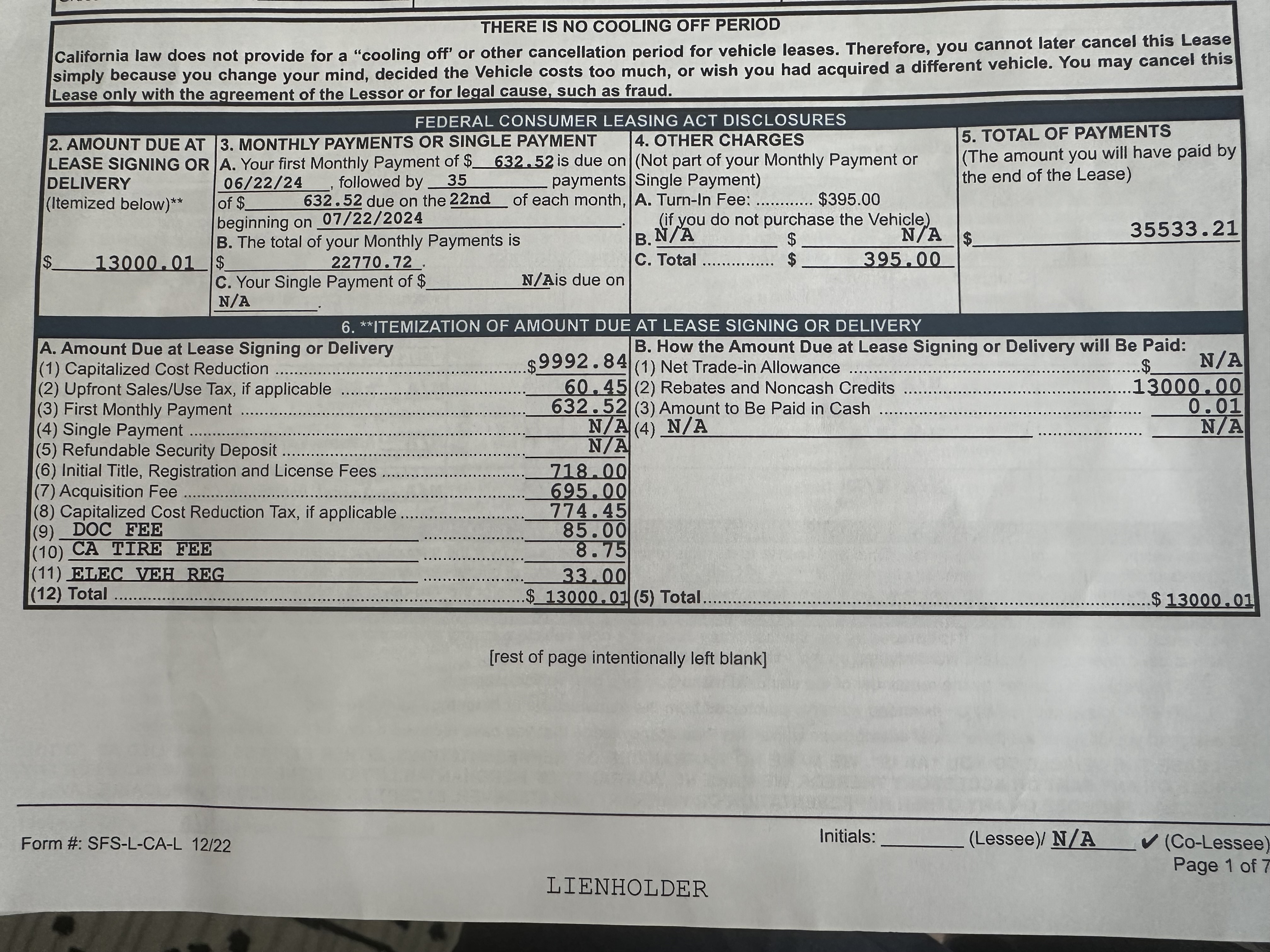

About to ink the deal - anyone have any thoughts or see any issues with this lease. Note I do plan to buy this out asap. Leasing to get the 13k in rebates

I qualify for all but the $1500 one, so im getting 13K instead of 14,500. acquisition should be 595 but they aren’t budging on the 695 price. Yes gov fees look wrong because I put the VLF portion as taxed and the rest as untaxed. They mentioned this is how SFS does it and that is the way the calc matched the lease contract

SFS acq fee for 36 month Rubicon leases right now is $995, not $595. If they’re charging you $695, you’re getting money off, not more. $695 is typical of a USBank. I would make damn sure they’re not doing a USBank lease and getting to that discount percent by burying the IDL cash in it.

Maybe this will help. Note this is from the 10.5% discount in earlier negotiations. Now I’m at 14.9%. MSRP is $66935
Either way does this look right? Should be a zero drive off but they are taking $$$ out of the 13k in rebates reducing the capital cost reduction. Also why is box5 so high compared to box 3b. It’s so confusing and I appreciate the help
It’s perfectly reasonable and expected for them to be paying driveoffs out of the rebate if youre doing $0 due at sale. It can’t all go to reducing the capitalized cost.
Box 5 is high because it includes the rebates.
Thank you. I appreciate it. Last question with this contract what would be the buy out price if I decided to buy out right after the first payment. I’m a cash buyer but only wanted to lease to get the 13k in rebated. Will the buy price be msrp less dealer discount less 13k rebates essentially 20k off msrp plus taxes etc?
A little over $50k plus applicable taxes
