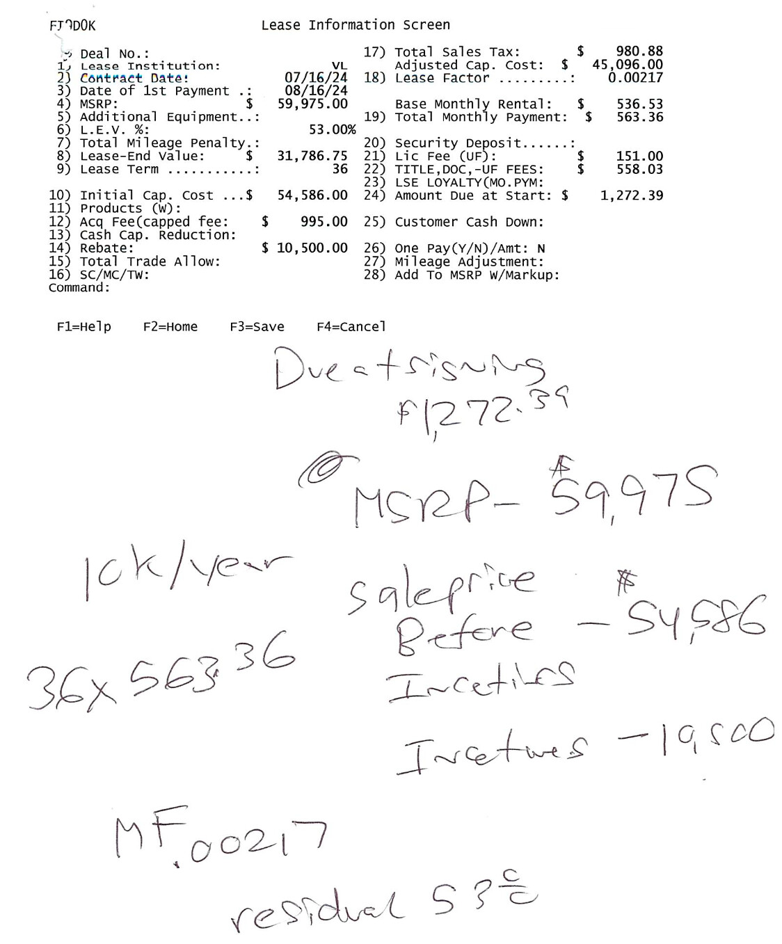

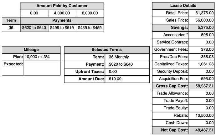

Below are the two offers I’ve received so far, both from Illinois dealerships. I tried my best to fill out the LeaseHackr calculator based on the information provided, so please let me know if I got anything wrong! Thanks in advance for any help you can provide!
Option 1:
  • Note - I plan to request that the $595 theft deterrent “accessory” be removed as their first quote actually included almost $3k in “offered accessories” that I stated I didn’t want. But the sales manager created the second quote and left this one on there.
Caculator
Option 2:
Calculator

As an update, I sent the offer I received listed above as “option 2” to another dealership I had been in contact with to see if they could beat it, as they have a very similarly spec’d vehicle listed. The salesman came back with a response stating that he discussed with his manager who opted to “take a pass” because they only have one S60 Recharge on their lot and they didn’t want to “take a short deal on it” since it is no longer being produced. He followed up by stating “based on your deal from the other dealership you are getting a very fair deal.”

Ask option 1 what the MF is. Something isn’t adding up. I can’t see how the effective payment would be $45 higher for (when you take into account higher msrp, lower acq fee, and add the accessory) what is basically $875’ish net additional bottom-line. If they are using the same MF as Option 2, it should be an effective payment about $25 more.
it’s true.
Thank you! In the email that I received alongside the lease offer that I screenshotted, they confirmed the MF was 0.00217. But I should still be requesting/confirming that the MF be documented and matches that on the final lease worksheet, right?
As an aside, when I sent the offer from option #2 to another dealership, I was told by them that the dealership that made that offer used the wrong taxes and fees, however he didn’t provide further clarification. I can’t say I fully understand how to calculate the taxes and fees other than understanding that Iowa vehicle tax is 5%, but is it possible that is the reason the monthly payments between options 1 and 2 are $45 apart and not closer to $25 as you are saying they should be?
Anything is possible.
But I don’t know how it is $1k in up front tax to begin with. 5% of the $10,500 incentive is only $525. Another $30 tax on the acq fee. Doc fee would also be taxed but they lumped the fees together, so I don’t know what that is. Even if all fees were taxed, you still wouldn’t get to $1k. Maybe Iowa taxes incentives differently? Do you have some sort of additional up-front tax on a lease in your state?
Yes I believe Iowa applies a 5% “use tax” based on the monthly payment and the term of the lease… I just can’t seem to get any of my numbers to match the taxes calculated on the offers I’ve received so I seem to be messing up somewhere when I try to confirm what exactly is being taxed :sweat_smile:
The 5% on payment is already in the final number. 536 base and 563 with the 5% tax. The up-front $998 is what is due on anything paid up front, including incentives, minus government fees.
Edit: oh, this is confusing, but it looks like you may have 5% sales tax but an additional local tax and/or use tax? And I assume that is up-front on total lease cost, so that could be the problem. Still not sure why another dealer would claim you aren’t being charged enough.
