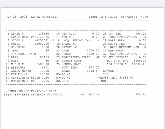

Just signed a lease on the 2025 GMC Sierra EV Denali — MSRP $93,585 — for $774.71/month with only $3,000 due at signing.
Here are the key numbers:
• MSRP: $93,585
• Selling Price: $82,000 (~12.3% off MSRP)
• Rebate: $2,500
• Money Factor: 0.00159 (base rate)
• Residual: 66.01% ($61,235.46)
• Term: 36 months / 10k miles per year
• Doc Fee: $998
• Gov/Reg Fees + Taxes: $8,798 (capitalized)
• Monthly Payment: $774.71
• Total Due at Signing: $3,000

Chapstick isn’t as savvy as you think. Your posted dealer WS is garbage. You claim that the 8798 tax is capitalized is impossible b/c the adj cap must be 80984.36 in order to get a payment of 774.71 Recognize that…
Gross Cap = Sell price + capped amounts
Adj. Cap = Gross cap - cap reductions
Given that SP = 823000 with capped amounts of 998 and 8798 and a cap reduction of 5500 there is no way you can achieve an adj cap of 80984. In fact, you’ll be around 86300. The WS does not identify the cap reductions, or all amounts capitalized. I suspect that there may be other fees that weren’t disclosed.

Don’t waste time trying to decipher a dealer’s worksheet or allowing AI to do all your work. Dealers will eat you alive by allowing them to control the deal. They often omit a lot of relevant detail such as money factor, fees not itemized and even make mistakes. You need to rely on credible outside sources (e.g., LH marketplace and signed deals, Edmunds, etc.). Do your own research and establish a reasonable selling price in your market. Be sure to get a copy of the factory window sticker. Check for non-factory add-ons or dealer-installed options. And, if possible, eliminate those you don’t need or want. Get a list of all customer and dealer rebates/incentives including VIN#-specific discounts/incentives, if any. And, yes, the dealer has such a list.
The only thing useful about dealer lease worksheets is the input data. All data should be vetted such as acquisition fee, doc fee (regulated by some states), cost of money (e.g., money factor), gov fees, residual, rebates/incentives, sales tax rate, etc. Make sure the residual matches the term and annual mileage requirement. Check available tax credits/incentives via the fund provider who may cover taxes or, at minimum, may assess a lower sales tax rate to energize sales for some models (e.g., Texas).

As for the worksheet responses — I fed the initial dealer worksheet into ChatGPT and asked it to evaluate the cap cost, MF, and taxes. It flagged that the math didn’t add up if the $8,798 in taxes were capitalized, and when I later reviewed the final signed lease, it was right — those taxes weren’t actually rolled in. That back-and-forth helped me spot that the worksheet was misleading and made me more confident going into the signing.

MA taxes on the monthly payment. How does your deal have $8798 in capped taxes?
Great catch — it doesn’t. The original dealer worksheet mistakenly showed $8,798 as “capped taxes,” but that didn’t carry over to the final lease. I’m in MA, where tax is applied only to the monthly payment, not upfront. The final lease contract reflects that — no $8,798 was actually capitalized. Just another example of why you can’t trust a dealer worksheet at face value.
