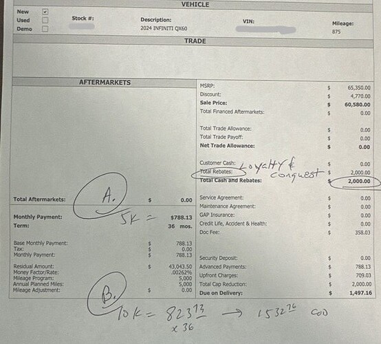

Hello all and thanks in advance. Talking to a dealer for 2024 QX60 DEMO with 900 miles. They said Infiniti has fiscal year end in March so maybe there is opportunity to get a good deal.
MSRP $65,350
Discount $4,770
Sale Price before incentives: $60,580.00
Incentives/Rebates: $2k (nissan loyatly + conquest)
36mo @ 5k/yr - the new signatureFlex lease plan.
66% RV, 0.00262 MF
Their offer is $788.13/mo
Due at signing = 1st month payment + $710 (doc fee/reg/plates)
in all of this im assuming the lease acquisition fee is included but will of course need to verify since it was not asked for at signing.
Using their numbers im getting $775/mo (Calc Link)
so while the numbers are slightly off… my bigger concern is whether i should be pushing for greater discount since it is a demo w/ 900 miles?? Thoughts?
Im attaching a picture of their offer directly below. hopefully it shows up.

Yup, I would push for a higher discount. Aside from that, here’s what I have…
Sell price = 60580.00
Capped Fees = 2970.84 This is the biggest issue as far as the offer is concerned
Gross cap = 63550.84
CCR = 2000.00
Adj. Cap = 61550.84
The capped 2970.84 seems awfully high to me and probably includes all taxes, acq. fee, and God only knows what else. What’s missing is your state, sales tax rate, fund provider and an itemization of all capped items. I have no idea what 823.73 x 36 -------> 1532.76 COD means. Looks like pure slop. These people must be a bunch of nervous wrecks… many dealers work way to fast and seem to make lots of mistakes.
As a sidebar, I noticed that the MF = .00262%. The idiot what created this knows nothing about a money factor. .00262% means .0000262 the equivalent of about 0.06%. Heck, I’ll take it! A lot of dealer/desking software is garbage.
RF = 66% means an RV = .66 x 65350 = 43131.00. Why are they showing 43043.50 which reflects a funky RF = 65.866…%. They also show 0 mileage adjustment.
So the dealer offered two options a 36/5 and 36/10. the hand written numbers is the 36/10. I’m able to track the pricing and manual calc/LH calc is just $10/mo difference. As an aside, i dont think ive ever seen a lease printout that made perfect sense.
Therefore i will simply counter with heavier discount on demo to get the desired pricing.
I agree the THE biggest issue is the dealer discount and needs to be upwards to 20% as @cheapdad00 suggested. I did all the calculations manually and mine agree with those of the dealer’s including the 788.13 payment. Thanks for clarifying their slop… B looked like T0k but now I see it… but .00262% … gimme a break. I’ve seen much better worksheets and still think the capped 2970.84 ought to be itemized.
