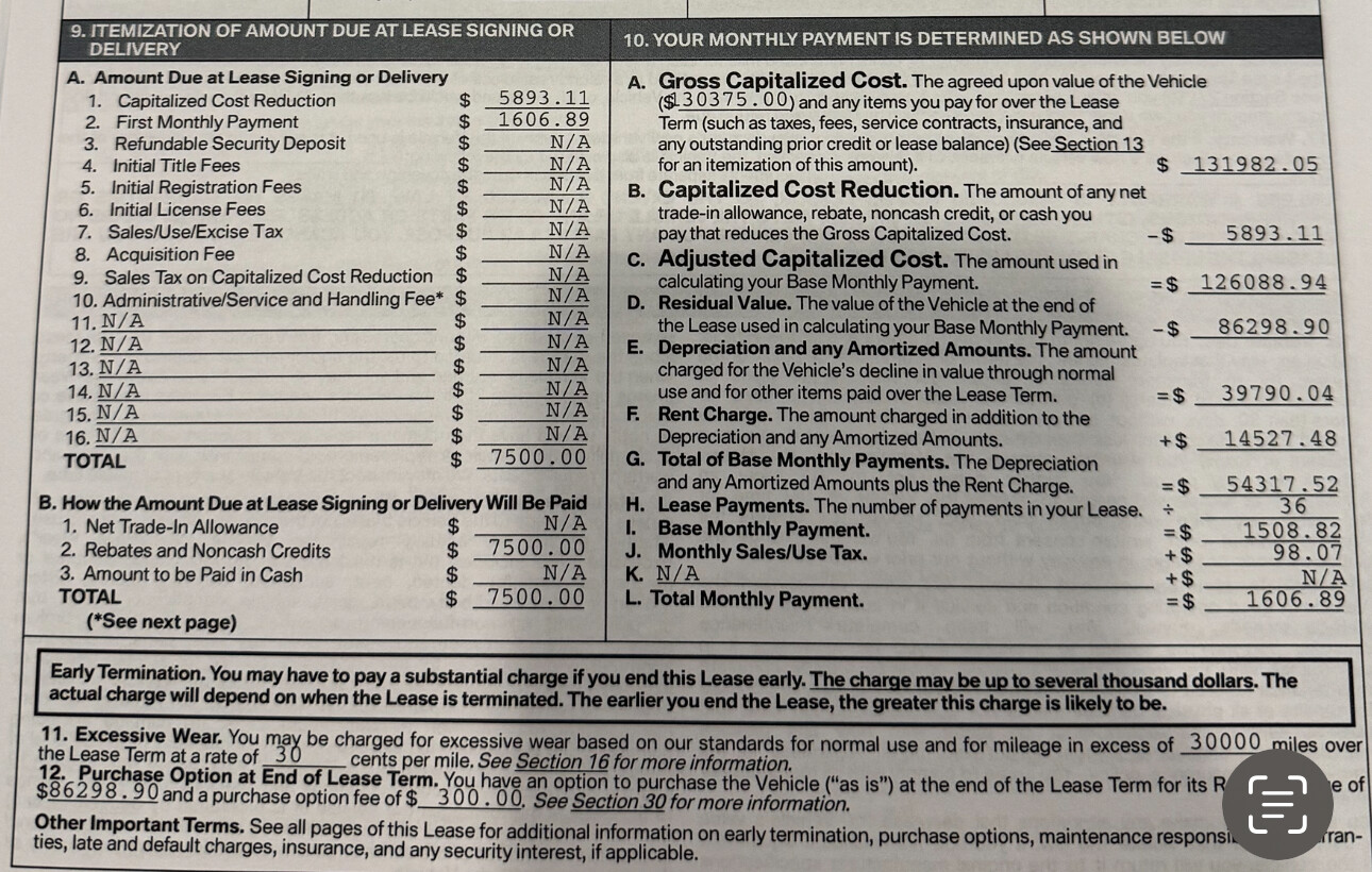

I think you can do better; here is my XM number, and it’s not even “LH worthy”:
