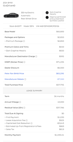

First time attempting to lease and am trying to model the quote in the calculator to obtain a better understanding but with only partial success. There is an EV credit of $7500 that I might not be modeling correctly and I couldn’t figure out where to put the cap cost reduction. I got the money factor over the phone.

And the quote:
Any insight will be greatly appreciated since I’m trying to decide if I’m better off forgoing the credit and buying the vehicle instead.
Incentives are taxed, youre missing dealer fee, theyre likely marking the mf up, and probably have some other dealer add ons.
They’re definitely marking up the MF.

I don’t use calculators except for those I developed. So, here is what I’ve generated using my Excel lease program given the data you provided coupled with some commentary…
MSRP = 71,295.00
Res. Factor = 53%
Residual = 53% x 71,295.00 = 37,786.35
MF = 0.00285 (appears to be marked-up (check the buy rate on Edmunds)
Term = 36 mo.
Tax Rate = 9.00%
Sales Tax = 9% x (7500.00 + 925.00 + 675.00) = 819.00
It appears that taxable dealer fees amount to 675.00. Could be a Doc fee (seems high)
Given the 7,500.00 rebate, there are two allocations: (1) an amount allocated to a cap reduction and (2) an amount allocated to paying all upfront fees. The allocation in the dealer’s worksheet is not accurate and should reflect a 3,862.83 cap reduction (CCR) and 3,637.17 applied to all upfront fees (rebate credit). So, here is how it should align…
Sell Price = 65,295.00
CCR = 3,862.83
Adj. Cap = 61,432.17
Base Payment = 939.60
= .00285 x (61,432.17 + 37,786.35) + (61,432,17 - 37,786.35)/36
Lease Payment = 1,024.17
= 1.09 x 939.60
Upfront Fees
1st Payment = 1,024.17
Acq. Fee = 925.00
Reg. & Fees = 869.00
Taxes = 819.00
Total Charges = 3,637.17
Rebate Credit = 3,637.17
Total DAS = 0.00
The dealer WS is structured so that the rebate credit (not cap reduction) is 3,643 and the cap reduction is 3,681.29….
Serll Price = 65,295.00
CCR = 3,681.29
Adj. Cap = 61,613.71
Base Payment = 945.17
= .00285 x (61,613.71 + 37,786.35) + (61,613.71 - 37,786.35)/36
Lease Payment = 1,030.24
= 1.09 x 945.17
And, here is the problem…
CCR = 3,681.29
Rebate Credit = 3,643.00 (see WS)
TOTAL = 7,324.29
Do you see the problem? The total should be 7,500.00, not 7,324.29. I would ask the dealer what happened to the remaining 175.71. The allocation was inaccurate. They should either cut you a check for 175.71 or re-allocate as shown above.

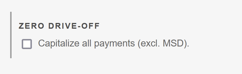

Had to get creative and make some unconventional adjustments but here is my LH calculator result using the correct allocation…
Had to increase the sell price by 7,306 and show the 7,306 as a taxed incentive so that the tax is correct. This illustrates the kind of problems one can encounter with on-line calculators although, LH is the best I’ve seen. At least you can manipulate the data if you know what you’re doing to get accurate results. However, there is no way to get the DAS = 0 as far as I know. You just have to know that the balance (7500.00 - 3,862.83 = 3,637.17) is used to pay all the upfront fees leaving you with DAS =0.
Here is the LH calculator filled out for the deal offered. MF is marked up to .00295
I was trying to model the dealer’s WS but with the correct allocation. How did you get dealer and government fees of 85 and 784, respectively? Guess and check? Looks like an adjustment to get the payment to match. I actually thought about checking the cap all payments box but we’re not capping anything in this lease, and it wouldn’t mimic the dealer’s WS. I would like to see an itemization of taxes and all fees capped in the lease. I wouldn’t want the first payment capped. Anyway, thanks for providing me with some insight. I’ll try this approach in my spreadsheet but I’m sure I’ll get much different results. I’d like to see the code for the LH calculator to see what it’s actually doing.
