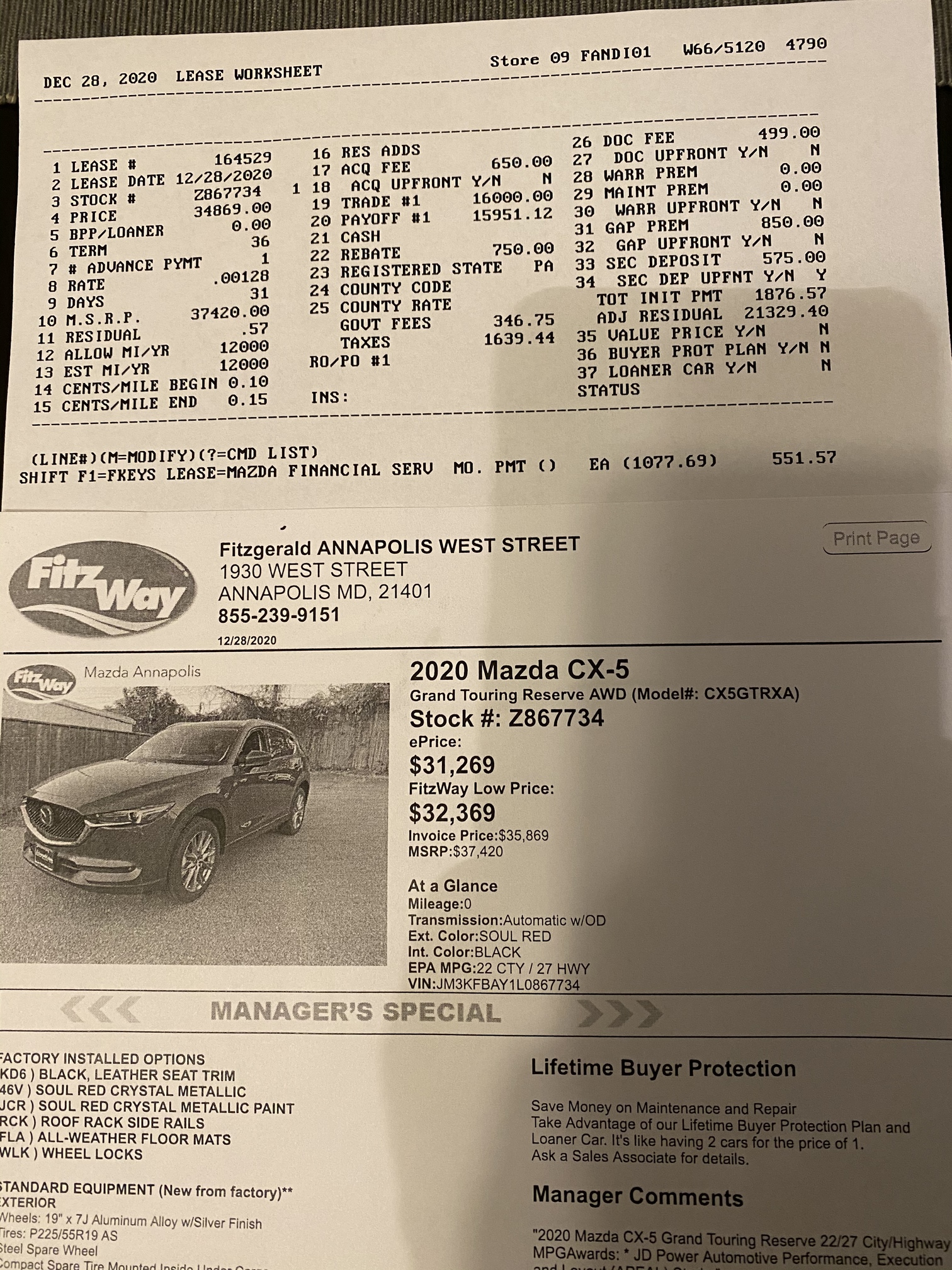

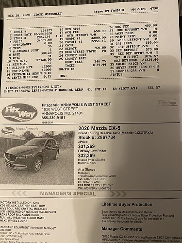

I’d like to get your opinions on the below lease deal I was offered today. Which is honestly laughable to me. I’ve leased a few cars in my time, mostly putting down next to nothing and walking out with a decent deal. Granted I spend 6 hours in the dealership each time negotiating. I’m currently leasing a 2019 Mazda 3 select for $240/mo and a 2017 CX5 Touring for $252/mo. 12k on each. The only money put towards each lease is from old trade-ins, got $1,500/ea per vehicle on each of the listed, most recent leases.
Today I went to trade in my cx5 as the lease is up in February. Really liked a 2020 GTR listed at $31,269. Stupid me, the actual price is $34,869 because the dealer said that price was for all cash buyers.
Okay, so $34,869 is the price and the RV is $21,329. I get hit with a monthly price of $550/mo. Informed the sales manager the pricing is outrageous, more than twice what I’m paying for close to the same vehicle. Why so high? The difference between the offered price and residual is $13,500 or $375/mo. Why $550 I ask? Well, taxes and fees says the dealer. I tell him we’re way too far apart, what can we work out realistically? He says they give all their prices as best and final upfront and that’s that, we walk out.

Does the math make sense based on the info I provided? Looking for advice here, $550/mo lease on a 34k valued car doesn’t “feel” right! Considering my current leases for cars valued slightly less than that are more than half the price. After doing some research, most are in the $300-400 range with $0 down for the same car.

Thanks for bringing this to my attention. The lease calculator shows a lease payment of $463/mo based off the info I put in. I obviously knew the dealers quote was high, however I didn’t think I’d be at $463 for a cx5.
If you post your calculator link, we can look over to make sure it’s correctly reflecting the offer. A few dollars discrepancy isn’t abnormal, but it shouldn’t be off that much.

With the added incentive it comes to $454 (pre tax).
First time using this so I may have missed a number, however this should be pretty dame close unless I’m missing something huge.
Thanks. I assume the MF of .00128 is relatively low?

You’ve got a couple things working against you here. MD sucks from a tax standpoint on leases. You get to pay 6% sales tax on the purchase price rather than on the monthly like you’re used to. Also, they’re charging you $850 for gap insurance on this. Mazda recently switched from Chase bank to Toyota financial for their leases. Part of that change was getting Toyota’s policy of not including gap insurance on a lease, unlike basically everyone else. Those two alone are adding a good amount over your previous leases.
