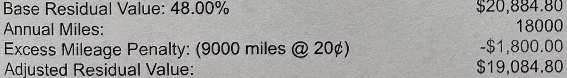

Gotcha, so are they giving me the benefit of a higher residual at 48%? I’m thinking of just going with 15k now but I was quoted at 48% residual for 15k, I’m thinking an error on their side.
No, they’re adjusting the residual accordingly
Because there isn’t an 18k program, you get the 15k numbers and then buy the extra 3k miles per year up front at 20 cents a mile.
You have almost $5,000 worth of equity in the deal as cap cost reduction, the rest is being used to pay up front costs like tax, tags, first month. That’s worth about $138 a month. If you keep it out of the deal and take the higher monthly payment you can just put that money in a savings account or whatever and draw down from it over the course of the lease to make up for the difference in monthly payment. And if something happens to the car you don’t lose all that money.
That 48% residual effectively becomes 44% when they adjust it to prepay the extra miles to get you to 18k a year.
Yeah, that makes sense now. I probably going to just go with the 15k regular programming miles.

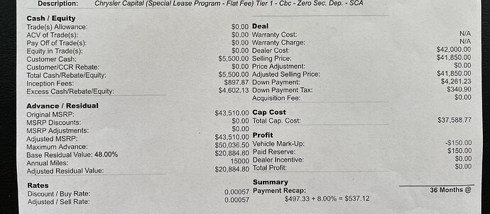

Here’s the second worksheet the dealer gave me. The $5,500 is the rebates which is being used for DAS, etc. Any input on this one? This is no money out of my pocket.
No, this is a terrible deal for a GC.
The quality of the deal is identical to before, you’ve just adjusted your cash out of pocket amounts. This is essentially the same horrible deal of full MSRP on a decade old grand cherokee.
It’s almost 4% off sticker which isn’t great but I’m not sure how deep a dealer will go on one of these nowadays.
