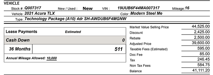

Hi:
I am trying to replicate the TLX deal posted in the forum. (below link)
I was not in the market for new car, but sold my 2020 Acura tlx apsec $7k Profit to vroom and picked up new 2021 Acura Tlx June 29. Also Reached out few brokers on leasehacker gave me $440 to $490 per month.
2021 Acura Tlx Apsec
MSRP: $ 45775
Selling Price: 40877
Monthly Payment: $ 348
Drive-Off Amount: $ 2700 ( All Fees Upfront)
Months: 36
Annual Mileage: 12k
MF:.00052
Residual: 26k(58 %)
Incentives: 3000
Region: Northeast
Leasehackr Score:
Leasehackr Calculator Link:CALCULATOR | L…
Above is one quote I got from a dealer. I put it in the calculator with MF & RV. they are from edmunds based on my zip code.
I select 0DAS but have about $100 gap between the quote and calculator. Any guess why? Is it RV & MF mark up?
Any advice is appreciated!

You’re double counting your incentives and including an extra $500 that isn’t in the dealer offer to start with. Also, your fees are pretty far off by a few hundred dollars. You’re not getting out the door with $250 in gov fees in CA.
This is much closer to the dealer offer shown:
The big difference between this offer and the deal you linked is they had an extra $500 in incentives and an extra $2500 in discount.

I see. I refreshed the calculator link before I pasted it here, forget to fix the gov fee. Now it makes sense. Thanks.
