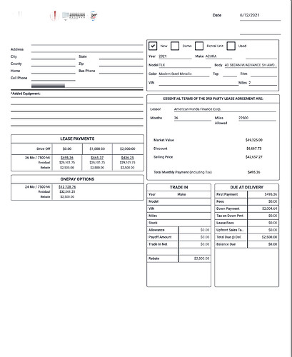

2021 Acura TLX Advance SH-AWD Quote Check
I’m waiting on an itemized quote sheet. I am aware of all the relevant figures and fees. Negotiate the price before disc. and incentives. know your MF/Res and all the other stuff.
My Total Cost: I expected to pay 1st months and that’s it. It looks like my Incentive was used for the “payment assistance” but I honestly thought it was worked into the discount due to it being 13.52% off. Can’t be both places, right? Didn’t compute and that’s why I’m waiting on the itemized info.
At the end of the day I know all the math and how to calculate leases. (Takes a while though.) I know what to watch out for and what to ask for but I’m no expert by any means. Getting a second opinion or 30 is perfectly fine. I always think there might be more blood to squeeze from the turnip. I know there is more discount there but the dealers are standing firmer of course. The dealers know they will probably get someone who will pay it. But I usually know when to stop, mostly. This isn’t my only option and I’m exploring other cars too or as much as the inventory allows. I’m also spurred on by the $3- 4K in equity I’m about to gain from selling my current Lexus lease. I’m having to special order (Lexus) and it might take 3-4 months and not sure how improved the market will become. Hopefully better.
But the bottom line is I’m pretty sure this is a good deal. The comparison deals i’ve reviewed along with competing price quotes. The research, the market, the math, not to mention the low inventory of this color and package.(in my area) I’ve checked 5 dealers and each only had 1 MSM color with Adv. Pkg. and AWD. Any payments that I’ve seen lower than $495 had trade equity and high DAS/OOP. So based on all of THAT…
2021 Acura TLX SH-AWD Advance.
-$0 DAS
-$2500 Conquest
$495.36/month 36/7.5k
MRSP: $49,325
Selling Price:$42.657.27?
Residual: $29,101.75 59%
MF .00052
My Total Cost:
$17337.60
Don’t base anything on that. Different people in different states have different lease programs due to different taxes, regional incentives, etc. Comparing pre-incentive discounts against others is great. Comparing monthly payments can be very misleading. Someone with a better deal may have a higher monthly payment than you because of these differences, etc.
How do the numbers compare to the target you put together before talking to dealers? Does your calculator based on the deal you think you’re getting match with the monthly/das from their offer? Have you confirmed mf/rv/incentives with edmunds? Acura loves to do direct to dealer incentives that should be properly accounted for in your calculator/target deal that wouldn’t show up on a dealer offer sheet.
That part was more facetious considering the tone of my post. And yes the 3 example deals/quotes I based that comment on were almost identical Make, model trim and years. 2 were similar in structure and one was VA. Yes, I took into meticulous consideration each residual point based on mileage differences in order to adjust up or down accordingly I checked each deals MF and each one’s credit profile to ensure that I adjusted my comparisons to keep them on par based on Tier 1,2,or 3. Then I reconfirmed who qualified for which incentive and how it was applied on their deal. I actually just about 2 hours ago submitted a request on the Acura forum on Edmunds specific to the 21 TLX in deals and questions section regarding the Factory to Dealer incentive that I discovered but like many incentives only applies in certain geographical areas. I have not checked yet to see if the forums have responded to my request to find out if the $1500 Factory to Dealer incentive is active/available in my area for me to even bring it up to my acura dealer. If you looked even remotely at the quote sheet I think you can about guess how far I’ve gotten in my quest for more precise information from the dealer. So yes, I have developed my own targets with said data that I do have and just ever so briefly browsed other examples as a vague comparison as opposed to a concrete basis to work with so that I could primarily gauge if the market was supporting what I believed it was versus what former expectations might have given us/ Just hoping I wasn’t $1000’s and $1,000’s apart. So yeah, I checked a little! :slight_smile:
Not out of my pocket. It was clearly discussed 3 times how I wanted the lease structured. It most likely is that the rebate is being used for the first months and other “down payment” that just so conveniently adds up to exactly $2500. I was surprised by the high discount but when I plug the numbers and adjust his creative maneuvering I get it to add up. It even shows in the box $0 Drive off and $495.36. / 36 months and that was an agreed number but I am still waiting on an itemized list.
Yes, it is 0 drive offs and 35 payments of 495.36
My TLX lease was written similarly with the 2500 incentive applied at signing as “manufacturer contribution”.

That’s ok. I appreciate the attempt. Your listing and calculator are what I started this whole process with as I was trying to find a local dealer that could beat your deal. So far they haven’t and I was going to reach out to see with broker fees and so on if it would be enough. After the tax adjustment to 6% and hitting the "Zero Drive-off " button I get $467. Your MSRP was $500 more but the savings was only $1008. So the broker fee and extra MSRP kills that dream!

13.5% pre incentive ? That’s pretty strong. Did you run the calculator to match up numbers?
Finally, did you look at the A Spec? (And all other TLX trims) I believe the A Spec has a better residual. If they’re willing to discount the same on a A Spec model, could be much better.
If everything pans out (base MF, no adds,etc), I’d jump on a 13.5% pre incentive discount
I don’t think it’s a great deal for a number of reasons. I hope you read the advice given here, verify all of the numbers, and consider other options.
