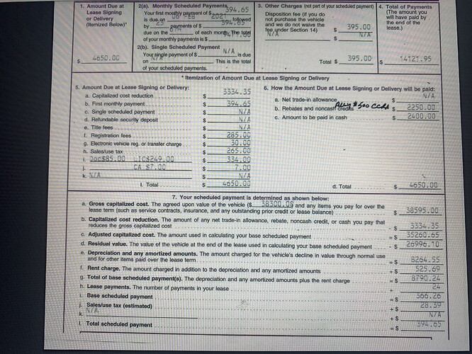

Here are the lease quote I received
Michael thank you again for your help did
You see the quotes posted below? Thoughts?
Michael - trying to calculate the MF and it seems terrible considering I qualify for top tier credit. Please correct me if I am wrong but believe calculation is
MF = total cost of lease (14,121.95) / (Agreed vehicle sale price (38,300) + RV (26,996))* Lease Term(24)
In this case this would equal a MF of .0090115 or 21.62%!!
Seems a bit ridiculous for top tier credit am I missing something?
MF=(Total rent charge / number of periods)/(adjusted cap cost + residual value)
Using that formula, MF appears to be .00035.
On the face of it, this seems like a good deal. 18% off MSRP and no F&I products added on. I don’t know what the buy rate is for this Ally lease, but .00035 is pretty low (0.84% APR).
Probably less than what you’d pay on a Q5 or GLC.
24 months usually seems to be the best option for Alfa even if the payment is slightly higher. The 30k service from Alfa can be pricey and is usually best to avoid if possible.
Appreciate that Michael thanks for doing the math clearly I had it incorrect. :confused:
I do think the 24mo. is better I may see if they can up the mileage to 12k for the same price but might be a long shot. at least overage is just .20 not higher.
Any other tips on shaving anything off?
