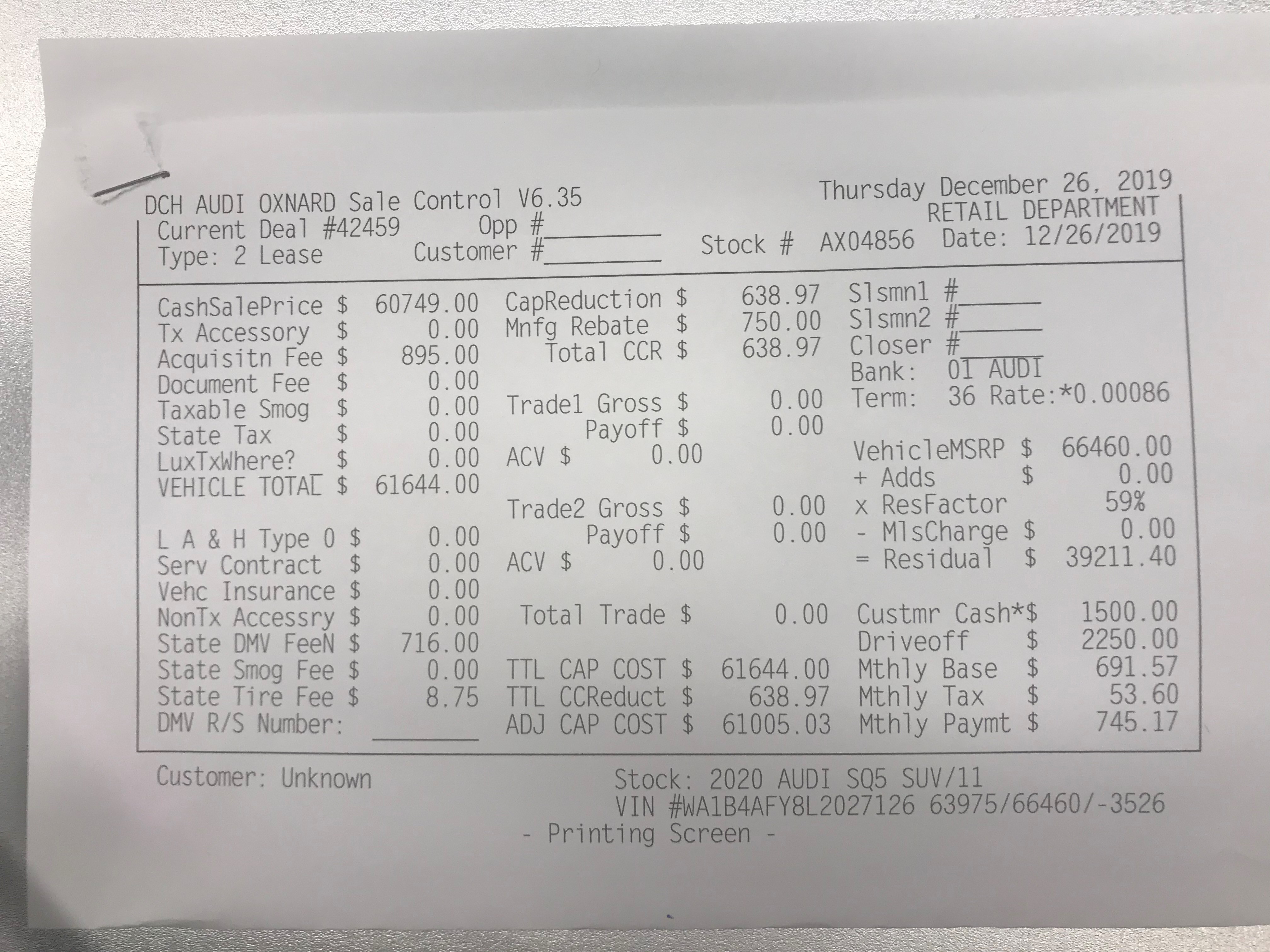

2020 SQ5 Prem+ (Link to vehicle)
MSRP: 66,460
Selling Price: 60,749 (8.6% discount)
  • $895 Acq
  • $638 CC Reduct
    Total: 61,005.03
MF 0.00086 (2.06%)
Residual 59%
36 month lease/10k miles per year
Monthly Depreciation: $605.38
Monthly Finance Charge: $86.19
Monthly Tax: $53.60
Total: $745.16/month
$1,500 out of pocket to cover first payment + DMV fees (Actually is $1,469.00)
Sales guy mentioned $750 mnfg rebate - but this didn’t reduce cap cost. Looks like they just added it to the driveoff total. Which they’ve listed $1,500 to cover fees… plus the $750 rebate? I don’t receive any benefit it from what I can tell. Can someone explain?

That’s buy rate and a solid discount on a 2020 SQ5. Maybe you can squeeze a bit more, but it’s already a good deal.
Can you give me any insight to the $750 rebate question? Wouldn’t the rebate drive the cap cost down?
Looks like the deal was desked with $2250 @ signing.
But, you only need to come up with $1500 because the $750 rebate is being applied to it.
6 of one. You could alternatively do $2250 @ signing and reduce the cap cost/payments by $750.
I would wait until you speak with one of the guys above who are in CA and can probably do better.
Donny I thought you had a much better deal on the 2020 SQ5.
Take the deal . It’s Kosher
