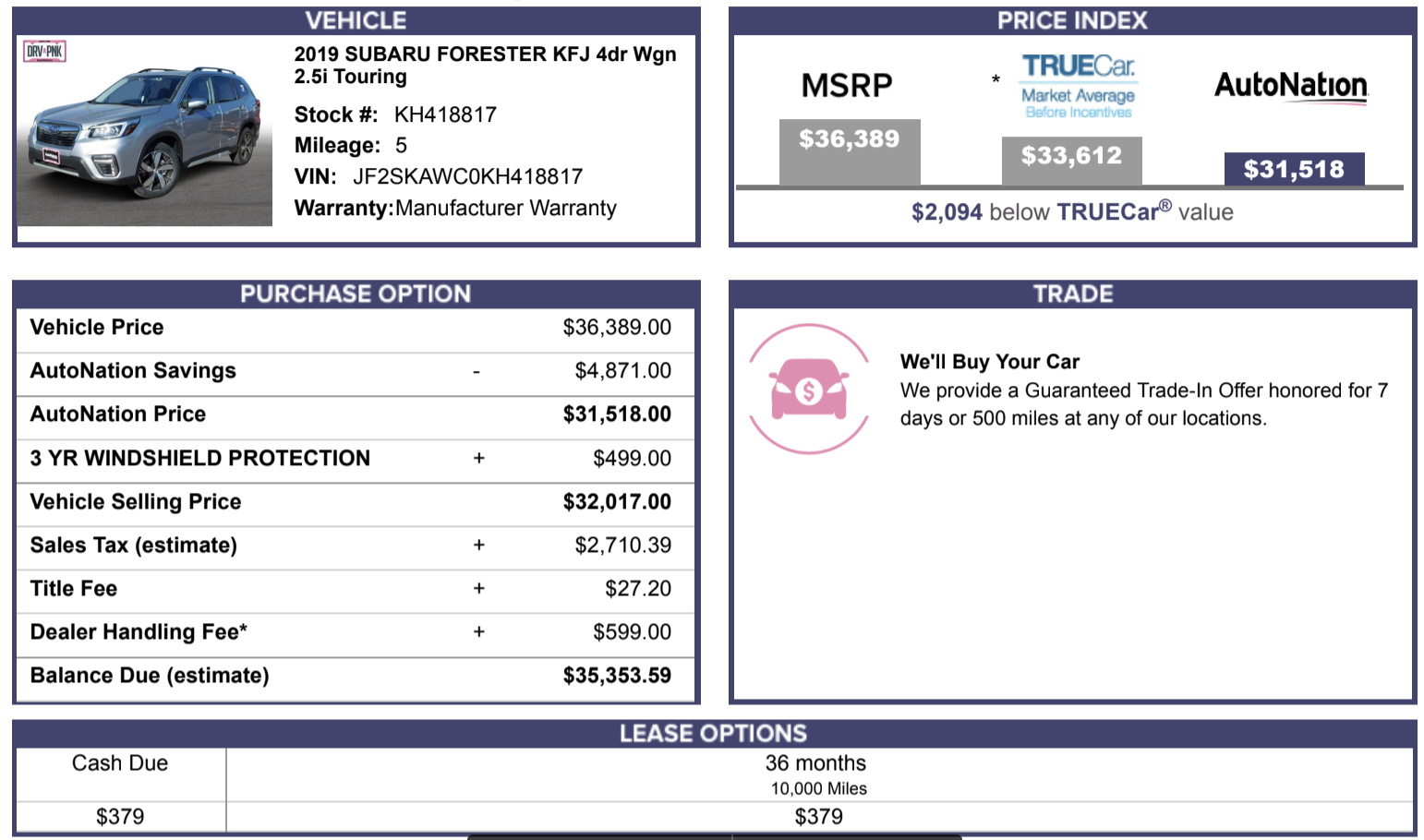

Finally snagged that deal sheet. I’ve removed my trade-in for simplicity sake. It actually made the sales tax increase, so I’m assuming I was getting some kind of tax break there. Still need to ditch the windshield package, but does this help?
I guess I still don’t understand why the sales tax (roughly 8% in my area) is added to the price of the vehicle, which would seem to make my payments higher…
Throw it in the calculator, that tax number is not on a lease. It’s just some crap their computer throws.
If I’m not mistaken your monthly payment of 379 already includes the monthly sales tax. They just rolled everything in to show you the final monthly payment instead of 349 + tax
What’s the invoice price?
The tax is listed under purchase option and is only charged if you do a purchase/finance.
An example of one of my leases,the tax estimate is always included in the breakdown.
Makes sense. I went in and talked to them last night and they were insistent that the monthly payments were correct (even though I calculated them here to be $50 per month lower). Do I just need to wait for them to put together the final leasing documents and verify that the tax isn’t included and the amount is more aligned to what I’m expecting based on my research? Seems crazy that they would do leases pretty often but not be able to tell me that the final numbers wouldn’t include that sales tax amount…
Here’s the part that obviously isn’t clicking for me. Are your lease payments based off the $38,448.52 amount, which includes sales tax? Or is it $33,787.10 (plus any fees you rolled into the amount)?
To me, it wouldn’t make sense for $4,186.42 to be added to the price of the vehicle before calculating lease payments, and then add sales tax on each lease payment. Wouldn’t that be double taxation?
This is probably a simple misunderstanding on my part, but would love it if you could point out where I’m wrong.
Just ignore the sales tax on the entire sales price part. They can’t and won’t charge you it.
99.9% of the time, user’s inputs into the LH calculator is wrong. Post a link of yours for us to compare to the lease worksheet.
