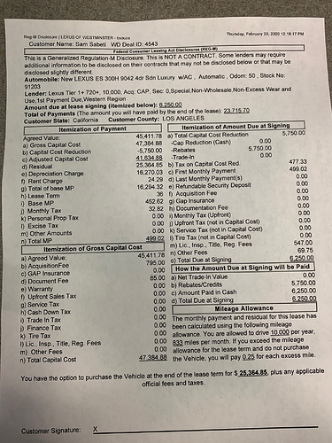

Does this help? What you think now Chris
Why does your $0 DAS lease deal say $6250 paid in cash?
im paying 500 in cash 5750 is the rebate is that why?
Ok, but $500 cash is still not $0 das
