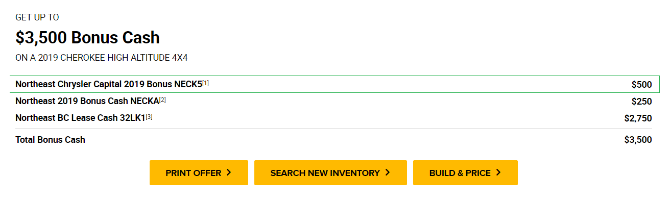

They are also claiming that there’s only $3k incentives (excl. loyalty) despite the Jeep site showing $3500 without loyalty for my area (11545) They said the Chrysler Cap Bonus NECK5 ($500) is for retail purchase only but it’s clearly shown as available on leases through Chrysler Capital. Am I missing some obvious reason as to why I wouldn’t be eligible for this? Can it not stack on the others?

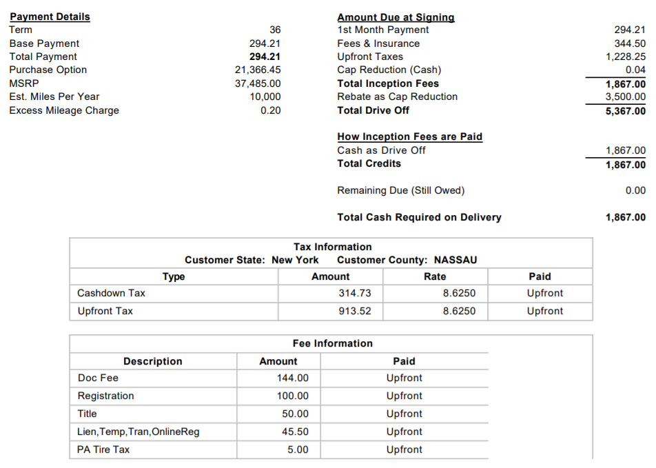

Not that there’s much interest here lol…but I finally got the numbers from the dealer. They’re using Ally, likely because the RV is much stronger compared to Chrysler Cap and MF/Incentives are still pretty good.
MSRP 37430
Sales Price: 34500 (~8%, still an assumption as they didn’t include in their worksheet but this works out in the calculator)
MF .000525 (1.26%)
RV 57%
Incentives 3500
DAS 1867 (1st month, tax + fees)
here’s dealer work sheet. I think there’s another 2% or so in discount before incentives. Thoughts?

Based on the dealer’s lease worksheet, here’s what I’ve calculated…
MSRP = 37,485 not 37,430 as you indicated
sell price = 34,006.18
acquisition fee = 595
gross cap = 34,601.18
cap reduction = 3,500 (rebate) + 149.04 (NOT 0.04 as shown in the worksheet) = 3,649.04
net cap = 30,952.14
residual = 57% x 37,485 = 21,366.45
monthly payment = 294.21
DAS should be 1,867 + 149 = 2,016 (the 1,867 includes 0.04)
Max NY doc fee is 75… don’t know why they show 144.
Ally bank uses an interest rate, not an MF. Calculations are based on an interest rate = 1.26%
The residual is discounted one month nearer to the present meaning the residual is a bit lower (21,344.04) than the 21,366.45 shown for purposes of computing the payment which will be a bit higher. I suspect Ally does this because they don’t charge a disposition fee. There is a residual buyout as Ally does not charge a purchase option fee. It used to be $2,500 a few years ago.
You need to get the sell price down.
Thanks for the feedback. The dealer is located in PA, would that explain why the doc fee is 144? All tax fees are based on ny but I guess any other fees would be dealer location e.g. the PA tire tax.
Where does the $149.04 in cap reduction come from in your calculation
Okay, so you’re dealing with a NY dealer and the car is going to be garaged in PA. That does explain the 144 doc fee.
As for the $149.04 cap reduction, note that the cash down tax is 314.73…
314.73 / 0.08625 = 3,649.04… is the cash down amount… of this amount, 3,500 is a rebate cap reduction and the balance of 149.04 reflects a cash cap reduction.
You got it backwards
Yeah. Dealer in PA, car will be registered in NY.
Sorry… I did get it backwards which is easy to do especially when you’re preoccupied with crunching numbers.
No worries at all. I appreciate your input and I don’t think that changes the story much at all anyway. Either way it explains the doc fee.
As you said, I need to get the sell price down and the dealer is claiming “no wiggle room” and most other local dealers don’t want to touch it. I feel so close yet so far.
