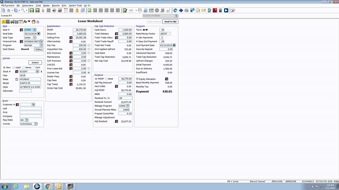

I’m trying to secure a deal on a Santa Fe Ultimate. From my research I’ve seen that Hyundai’s don’t lease well, but I’d like for someone to review the deal proposed to me. When I plug the numbers into the site calculator, I don’t get the same number the dealer shows.
MSRP - 38775
Selling Price - 35091.38
Incentives - 2900 (2400 lease cash, 500 regional event)
DAS - $1500 (tax, title, and first payment)
How does one get that worksheet?
The MF is abysmal. Is that really the base rate? If so, I’d look elsewhere.
I asked the dealer to provide me his worksheet. It’s a screenshot from his PC.

You’re right up the road (I71) from me. All the numbers were calculated correctly. Here are my concerns…
1st. The base payment is 393.86, not 428.05. The only purpose of the base payment is to compute taxes. In Ohio, taxes are calculated on the sum of he base payments (payment excludes non-taxable fees). The payment tax is…
36 x 393.86 x 8.00% = 1134.32
2nd. As already mentioned, the MF is horrible and equates to about 5.68%
3rd. You need at least another 12% off the MSRP. You need to compensation yourself for the terrible MF. Check this site and edmunds to see what others are paying in terms of a sell price.
The 325.24 charge due upfront should be itemized. My guess is that it includes DMV fees and tax on a portion of rebates and cap reduction. So, you have…
DAS… = 746.71 (cash cap reduc) + 428.05 (1st pay) + 325.24 = 1500

@delta737h, is there a reason why the base payment calculated for taxes ($394) is different than the final ($428)? Just curious on how that can be.

Yup! The base payment of 393.86 excludes the capped taxes as it is used to calculate taxes. The 428.05 includes the capped taxes. That’s why this payment is higher than the base.
Is that unavoidable, or can that be avoided by paying the taxes at signing?
