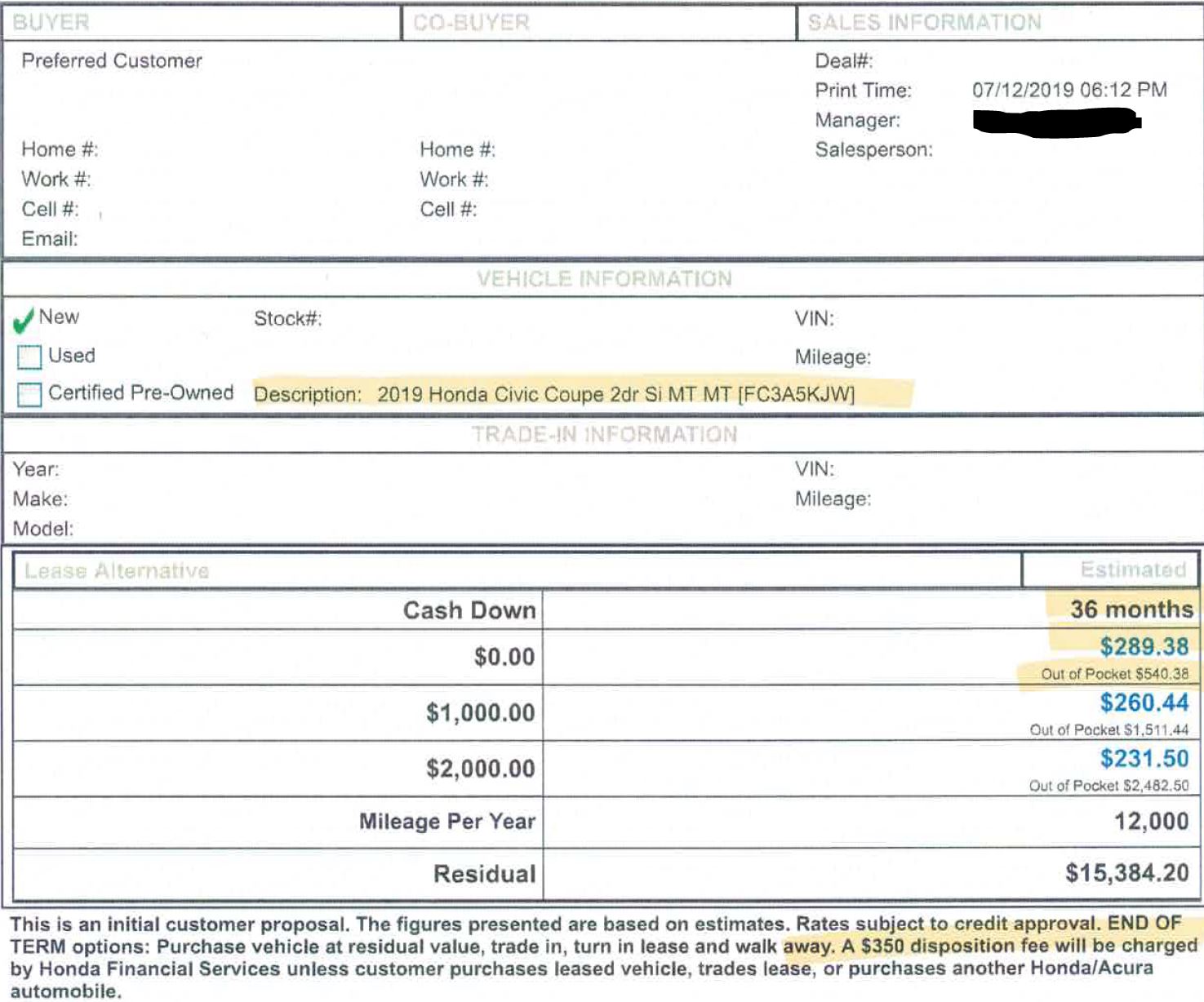

I just received this quote from the dealer. Is there anything that is jumping out as wrong? Any input will be helpful!
Thank you

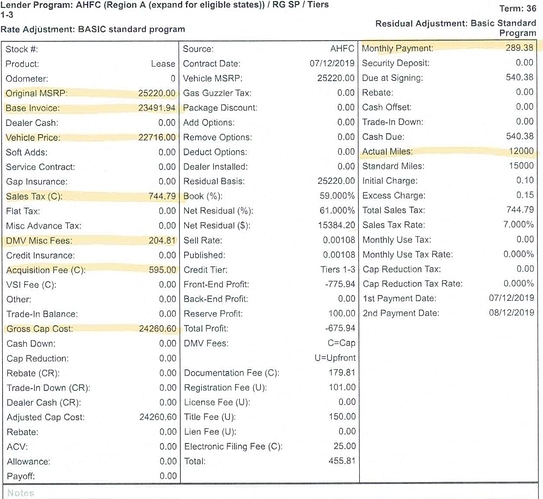

What is the reason that the Gross Cap Cost is jumping back up to 24,260.60? Vehicle price is at 22,716. Am I missing where they added $1000 in fees in there somewhere?
Thanks
The drives doesn’t cover all the DMV fees so some of that is capped along with the acq fee and some taxes.
Is the gross cap where it should be then?
There’s $744.79 in sales tax. So if that’s accurate for your tax area then that’s correct. You’ll need to verify how your taxes are calculated. The $595 acquisition fee is correct.
Okay thanks. Yes taxes are correct. Is getting my monthly down to 250 with 0 cash down realistic?
You’re at $750 DAS and $289/month. To get to 0 drive off and $250, you’d need to find another $3000 off. I think that’s probably a stretch.
Okay thanks. Does this quote look like a good deal then?
There must be other dealers that you can shop this quote around to? That’s usually how you grind down the final few dollars.
