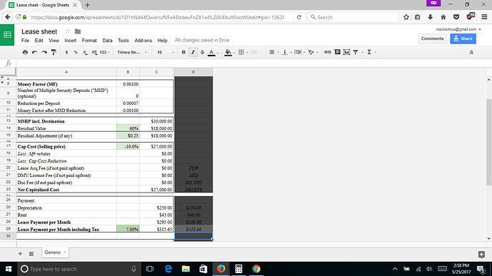

Your ‘rule of thumb’ is completely off. The correct rule of thumb is about differences in selling price on the same MSRP. I.e. everything else being equal, including MSRP, each $1,000 difference in selling price changes your monthly payment by ~$30, give or take.
You cannot compare cars with two different MSRP and apply this rule of thumb. To show you the absurdity of it: You say a $34K MSRP RAV4 should be $120/month more expensive than a $30K MSRP one (e.g., $420/month vs $300/month). By the same logic, a $26K MSRP RAV4 would be $120/month cheaper than the $30K one. Do you think that would ever be the case? That a $30K MSRP car would lease for $300 and the same car in a slightly lower trim and $26K MSRP would lease for $180?
Here’s the real math
$30K MSRP: $295 pre tax
$34K MSPR: $334 pre tax
All else remaining equal (RV, MF, % discount from MSRP on selling price, etc):
