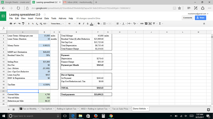

I’m looking at a 2017 X1 AWD loaner car with 4700 miles. 36mo/15k
msrp $46,620
sell $35,800
Miles 4,700 (that’ll add $1,175 to the residual at .25/mile)
residual 58% (3yr, 15k)
mf .00151
rebate 1,000
I’ve negotiated the selling price, now to flip it to a lease. I want to make sure that my math is correct.
Considering the parameters above and not adding anything for tag, dealer, or disposition. I live in a tax on payment state, 6.5%. I’m coming up with $366/mo including tax. Is that correct?

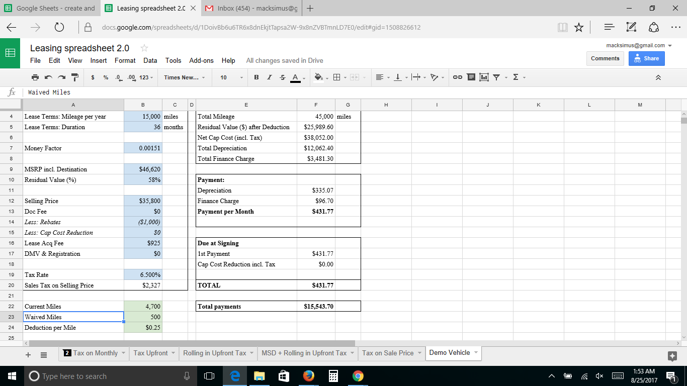

You deduct (NOT add) (4,700-500)*$0.25 from the residual of 58% * MSRP
Thanks for your help. But in your math, you charged sales tax on the full purchase price. Considering that I live in a state that charges sales tax on the payment, not the full purchase price, doesn’t that change the figures dramatically?

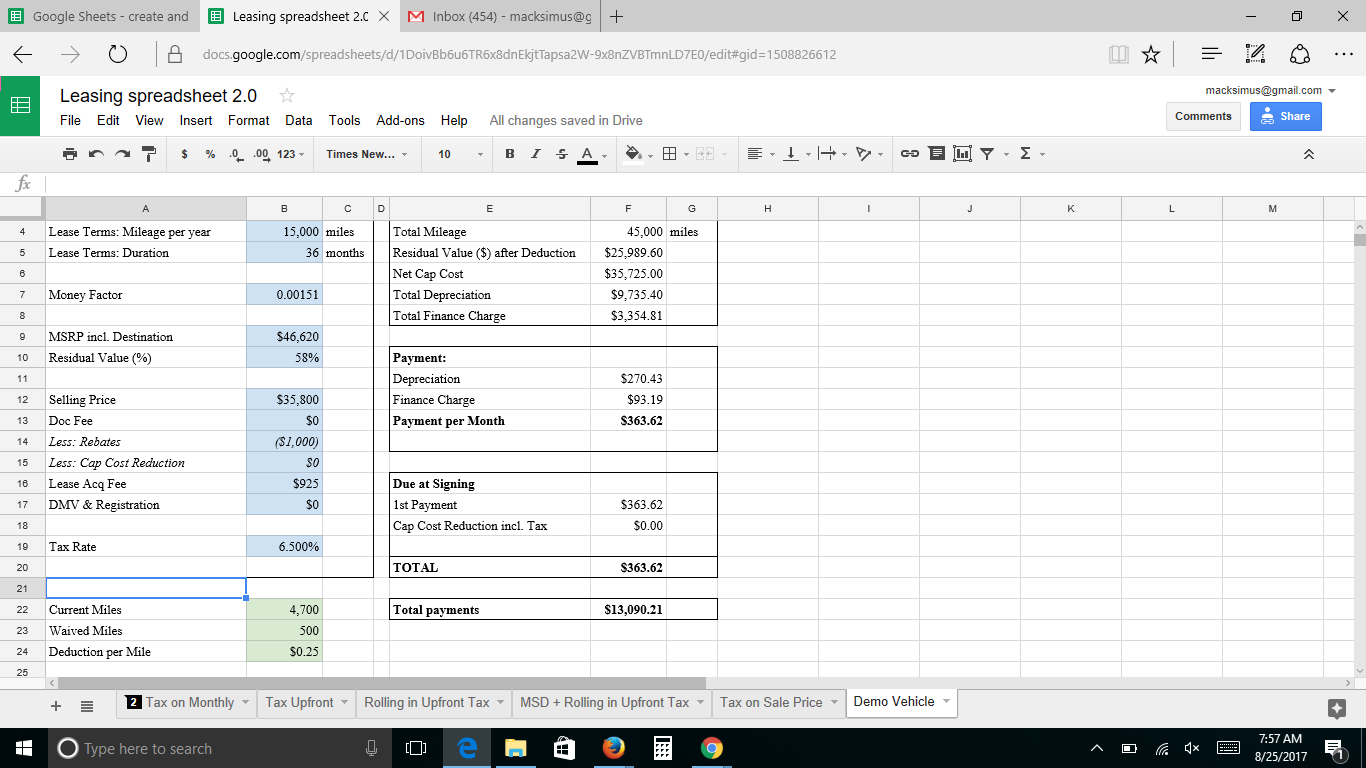

It does. You’d be at 363 plus tax
Cool spreadsheet, did you build it?
Yes. Thanks! …20
