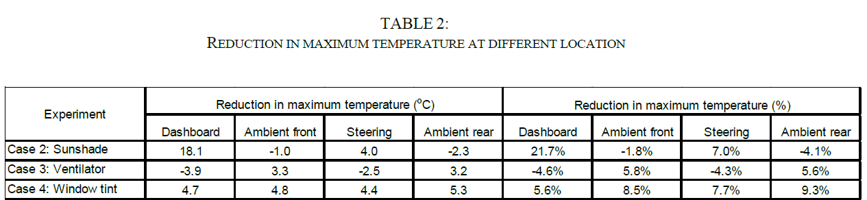

Just curious, how much cooler does this keep the car? Are there exact comparisons that show with and without in same car, same spot same time? It seems to me, a big hunk of metal and glass will heat up under the sun. Insulation can reduce temps, think, new environmental insulation standards for homes, but obviously, not possible in a vehicle.
Pretty significantly. It’s important to remember that on a hot day, the interior of cars get much hotter than ambient air due to the IR loading from the sun. It’s not just an issue of the outside of the car getting hot and then conducting in, but rather the interior acting like a greenhouse as the IR heats up all the air inside.
There was a study done in 2012 that compared a variety of different methods and was using some lower IR rejecting tints (75% rejection vs the the 95%+ available these days).
Some snippets from the study:
https://www.researchgate.net/publication/266136337_Experimental_comparison_study_of_the_passive_methods_in_reducing_car_cabin_interior_temperature/download
Ok thanks. So according to this one study, about 3 to 5 degrees cooler with tint, depending on location in vehicle.
More like 5 degrees, and celcius at that, so 8-9 degrees Fahrenheit. And that’s with lower performing tint

To be fair, though, anything above 45 deg C is going to be… blistering.
While tinted windows can keep the car cooler even over several hrs, did the authors mention any practical benefit to this?
