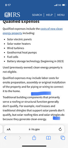

Looking for the latest guidance on the tax credit and solar projects. My house was built in 2004 using a 20-year shingle, so it’s at the end of it’s warranty life. Thus, my project includes a new roof and solar install.
I have priced it out from Tesla and my roofer.
I have priced it out from a solar company that does both.
Trying to understand if I can claim the 30% tax credit across the entire project cost or just the solar costs. And if the entire project, does it matter if I piece together my own provider(s), or must I use a single provider?

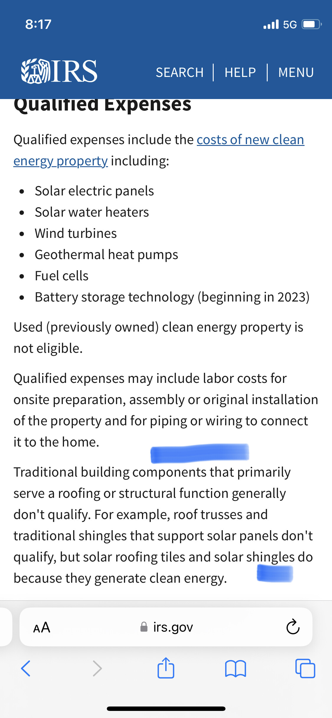

Hopefully @cyak has a little more guidance on this however this is what a quick search on the irs guidance shows. Looks like solar shingles or tiles are covered and traditional shingles are not. I know this doesn’t answer all your questions.
I agree the IRS guidance looks pretty straight forward, but I’ve still heard of people who, based on accountant guidance, claim the roof costs. I’m trying to figure out if I am missing some loophole whereby a traditional composite shingle roof can be included.

IRS has since made clarifying statements, so if you’re not using one of the materials described above, the only remaining loophole is the fact that the IRS lacks the manpower to audit all taxpayers and there are probably some roofers out there who would be happy to call your shingles solar collectors on an invoice.
