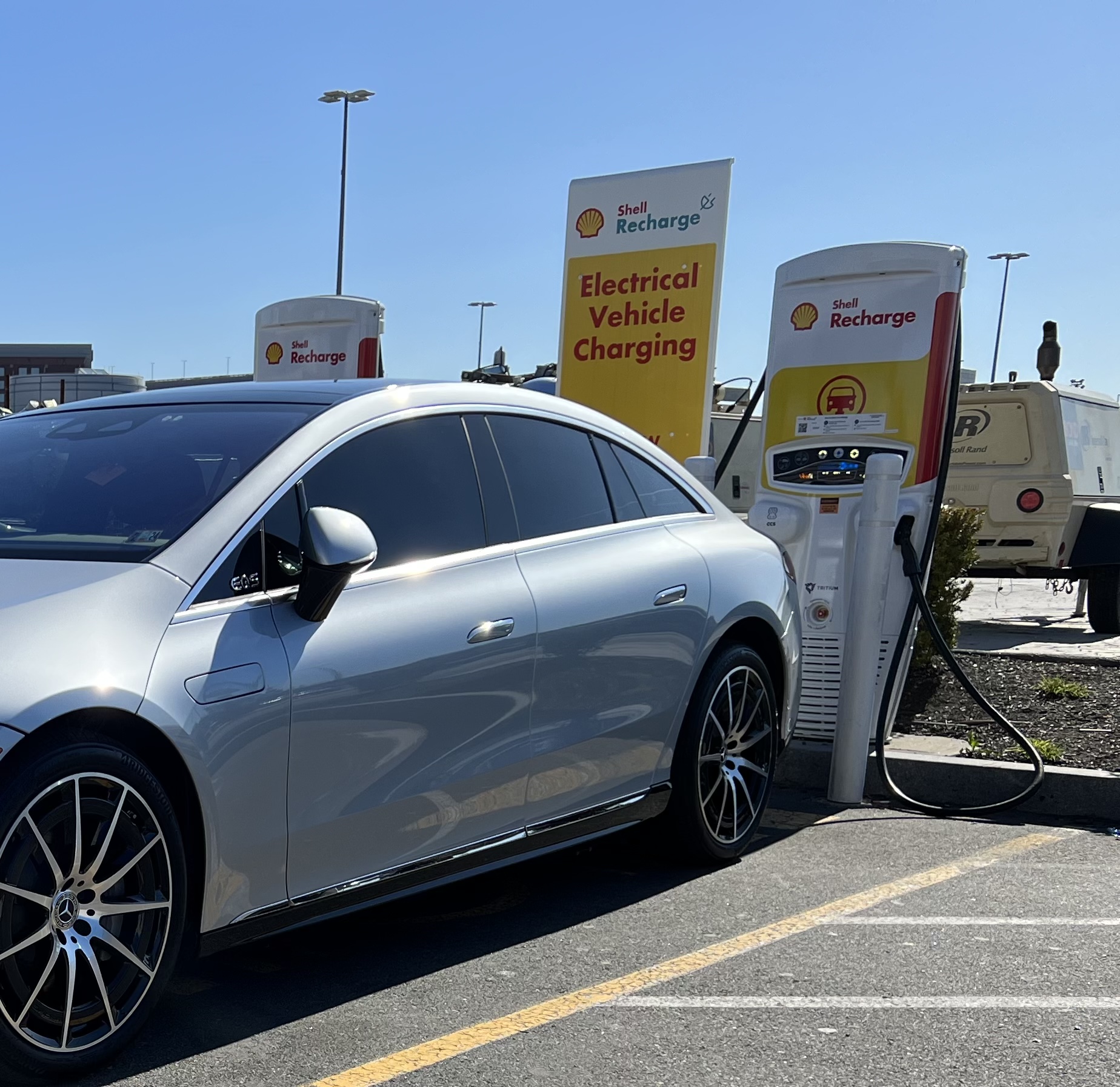

Shell came through on a road trip
What’s the wholesale electricity rate, what rate will you sell it for, and how much do you need to sell per day to break even? Isn’t that the back of napkin info you need to get an idea of the investment potential?
Shell electricity
