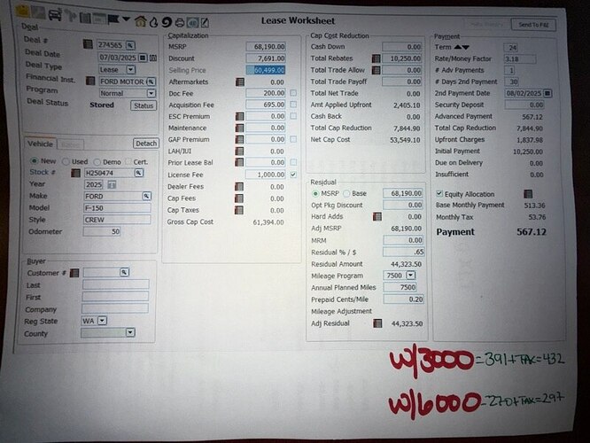

Hi there, looking to lease a lightning XLT. Got this quote, which expires 7/7 apparently with the employee pricing promo over. Is there anything I’m overlooking?
11% isnt bad, ask for 15
Its a base xlt so it doesnt have a lot of features
Thanks, will give it a shot.
Wouldnt hurt to get numbers on a flash, will this be work car or daily.
Just a daily, 20-30 miles a day throughout the week. Wasn’t all that interested in any of the features in the higher specs - just wanted to try owning a truck for a bit.
Do your math before doing 7.5k miles. 30 miles a day 7 days a week brings you 10k a year
Yep understood, it’s 5 days a week and is a second car. Will look at raising to 10k
What is $1000 license fee and $1837 upfront charges?
Also, taking the charging rebate will get you another $500.
That’ll save you another $20/mo
The MF is jacked to 3.14. Rate finder says .68 should be the apr. And how come they only used 7844 of the 10K rebate for cap reduction? Was the remaining 2405 used for a better msrp discount? I’m kinda confused looking at this.
Thank you, I have inquired.
Thank you, I have flagged.
The $1000 is for tabs here in WA
