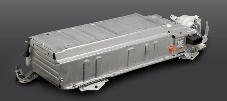

If we use the Prius as an litmus test for battery costs after 10 years, there are battery options available now at a fraction of the cost of what they were when it was new.

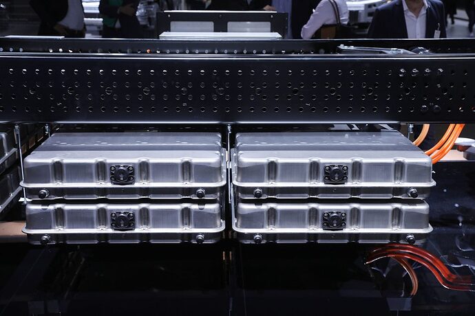

It’s easier to produce aftermarket when the pack size is miniscule. The bigger the pack and more integral it is to the structure the harder it is to replicate from scratch.
There’s been some serious strides made in refurbishing and or replacing modular components in failing packs but nothing is perfect and the costs out of warranty are still prohibitive for your average consumer.

True, but necessity is the mother of innovation and it’s already been demonstrated that with a giant hole in the market with the older priuses have come solutions.
When Toyota made the Prius the battery was likely in the range of 3% of the cost of the car. On a new Model 3 the battery is 30% of the cost- a much bigger chunk.
Toyota was charging $4k per kWH for a replacement, expensive even at the time. The aftermarket pulled it down to more like $1k per kWh, so a 4x reduction (not hard because the cells themselves are so cheap).

The prius batteries when new were like $12k

How many years back are you going to get 12k for the regular Prius? Over a decade?
Even so even way back in the day they never cost Toyota 12k. 3% of the car’s cost is based on cost to the manufacture, not price to consumer.

Yes, decade or so.
The fact of the matter is it was a $12kish battery replacement cost then and there are $2-3k options now.
Source for your $12k ten years ago? This article from 12 years ago discusses Prius battery replacement costs in the 2-3k range, so I’m not clear where you’re getting your figures from:
