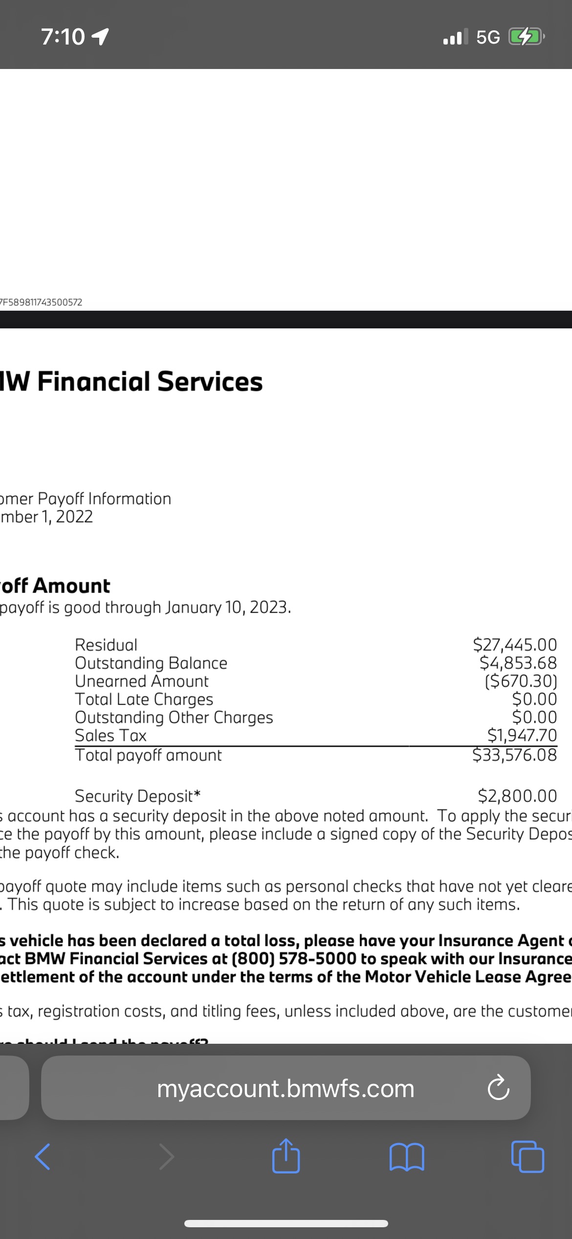

I have never seen a lease that keeps unearned rent charge. The adjusted lease balance that establishes your buyout amount would reflect the payment you had made.
Essentially, your buyout value would be lower than the residual value and increase each month until the buyout equaled the residual value at lease end.

Theyre not going to refund you anything. It lowers your payoff.
I believe the unpaid interest is credited as “unearned amount” with BMWFS.

I can tell you how the calculations SHOULD be done. Unfortunately, the FRBB’s Regulation M- Consumer Retail Leasing Act, doesn’t provide much guidance perhaps for political reasons and so, fund providers are free to compute lease balances, single pay credits, etc. in just about any manner they choose. The final authority is your BMW lease contract. Look for the early termination paragraph(s) to see how it’s done… Or you can post it or pm me with a copy of your contract and I’ll be glad to do all the calculations for you with all the details.
Actuarily, the way your one pay credit should be determined is by computing the present value of the remaining discounted payments at the interest rate (sometimes called the actuarial rate or constant yield rate) implicit in the lease at the time of termination. As you know that credit consists of two components: (1) an interest credit and (2) a depreciation credit. The interest credit is actually the residual value minus the present value of the residual computed at the point of termination. The depreciation credit is your single payment amount minus the interest credit.
Again, I don’t know how BMW does these calculations. There are probably as many different ways to do these calculations as there are fund providers (lol). Bottom line is that you should be entitled to a credit.

I doubt if they refund anything.
Check the payoff amount at your account and compare to the residual value.
