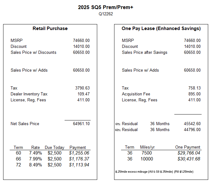

Hoping someone can provide some feedback. About to pull the trigger on a 2025 SQ5 (TX / 36m / 10k miles).
Got the 7k in rebates (national + costco), and an additional 7k off that. Planning to do a one time lease pay as it reduces the tax down from 6.25% to 1.25%.
Any feedback would be appreciated!
Do your best attempt at the calculation. On the surface looks no good especially without tax credits.

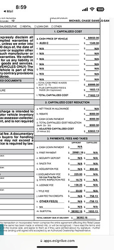

Thanks for the response. Attached is the full lease agreement breakdown (includes Audi Care). Looks like the tax credits are included in there bringing it to 1.25% instead of 6.25% unless I’m mistaken. Of my 14k discount, looks like only 6 of it is being applied to the capitalized cost. And then they’re taking 8k rebate off of that.
I suppose that is where they get me but I’m wondering if I can negotiate more off of my capitalized cost? I’m just having trouble seeing if there really is more room to draw them down.

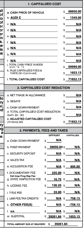

I am not the best w/ these things, but I don’t know what that means.
I also don’t see any indication of a rebate at all.
I agree w/ the other poster that you should make a best attempt at a calculator. Assuming you are correct about the rebates that can be applied, I think there’s a chance that your deal is actually at MSRP.

2b. is blank, what rebates are you talking about?
Apologies, was on mobile and unable to do the calculator in the moment. Here is the calculation however I couldn’t get it to fully align with my numbers. This is using a money factor of .003702 per dealer and RV of 61% (60%+1% for Audi Care): Leasehackr Calculator - Hack your next lease | Leasehackr
Since I first asked here, I was able to get the dealer to include the full discounts/rebates included in the capitalized costs as shown below. @leasefumblr they originally weren’t including those rebates in the adj cap cost, which is why it was blank. Now it shows the 8k.
Apologies @LeaserOC I should have included the calculator first. I’ve been adjusting the calculator based on my negotiations and also doing my own calculations but can never seem to deduce how these dealers ultimately get their numbers.
