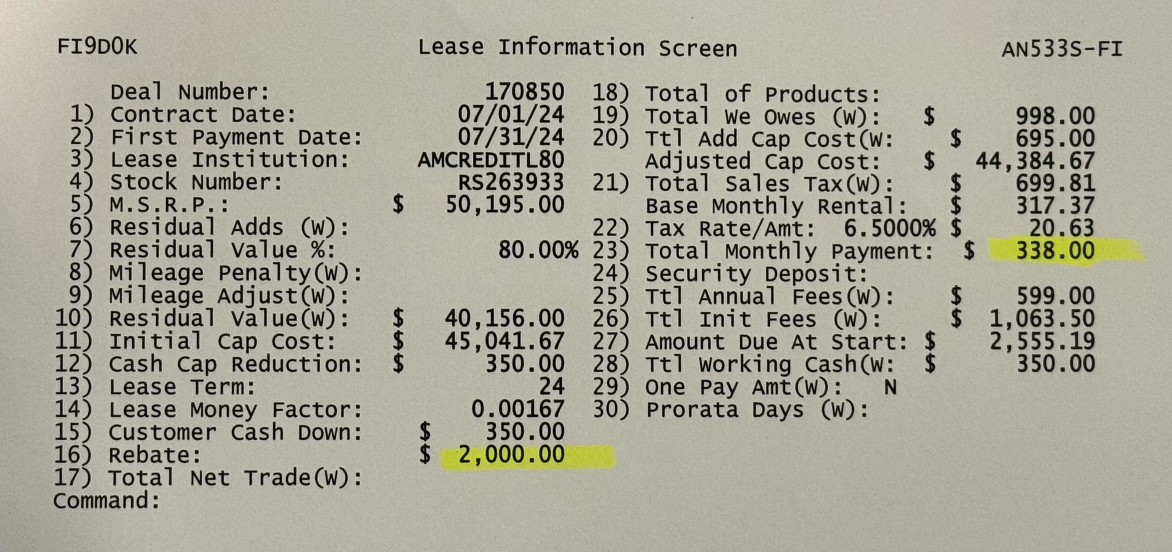

Hey gang… hoping to get some more eyes on this deal. They’re saying the FL system hack means they can only provide this printout as a deal sheet and I’m having trouble making everything add up.
Also, they first quoted me $44,323.43 selling price when I only had a $1,000 rebate, but looks like they bumped it to $45,041.67 once they got my second $1,000 rebate to work.
Thanks in advance!
For starters, I believe that the programs change starting tomorrow so this might not mean much of anything of you haven’t agreed and signed anything. Is this 24 months, 15k miles a year? The RV and MF seem to line up with that but the “AMCREDITL80” lending institution is throwing me off. Is this a GM Financial Lease? Is that just a Florida thing for them? I haven’t seen that before but I know some captive banks operate differently in the southeast. Your deal sheet appears to be showing a $695 acquisition fee when it shouldn’t, that’s waived on the Blazer EV. I’d ask why the sales price changed when you were quoted something different before you were able to get the other rebate. Which rebates do you qualify for anyway?

Apologies, didn’t realize the mileage wasn’t on there. This is a 24/12k deal.
Great info on acquisition, thank you.
No idea on the AMCREDITL80.
Yeah, I’d be demanding the original quoted price, not this one.
And I qualify for Costco and Supplier.
429 first payment due on 2k rebate at 24/15 was what I was running- looks to be right on it with your cash cap
They quoted you 24/15 (80% residual)
Thank you! Just confirming, that $429 was for 2LT?
And assuming I get those adjustments on initial cap and term, this seems like a solid deal?
You’re a Blazer legend, so if you give it the :ok_hand:I’ll definitely feel good about it haha
Squeeze em to peel off the 695 in line 20 (looks like the acq fee which should be 0$) and the residual should be 81%-
Get those and peel you cap cost to 0- and you should be at about as good as you could get for June!

Update: They refused to acknowledge or correct any of their mistakes and basically said “take it or leave it.”
It was a decent deal even with the shady bits, but the fact that they wouldn’t even fix the obviously-wrong residual was too much of a red flag. I passed.
