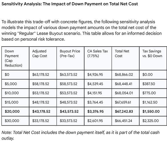

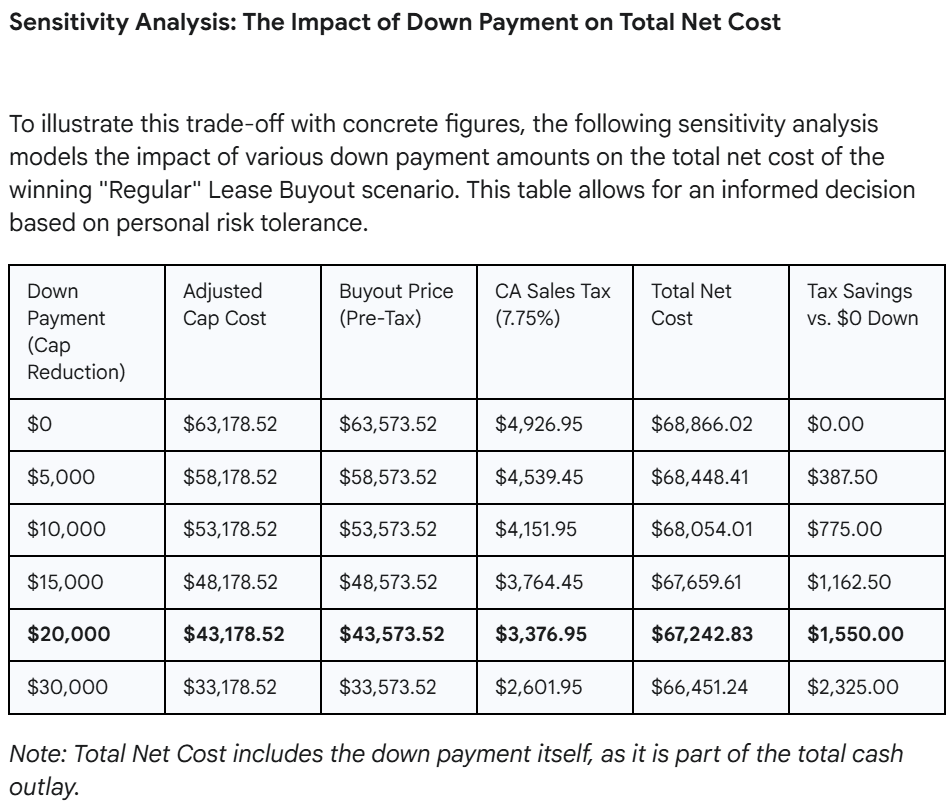

I ran my numbers via ChatGPT and asked it to use LH forum as a reference. It told me this about large down payments for CA immediate early lease buyout could reduce my taxes. I’m interested in reducing my tax burden if this is true. Here is the ChatGPT output.
“The analysis confirms that a larger down payment yields a proportionally larger, guaranteed tax saving. A $20,000 down payment reduces the total cost by an additional $1,550 compared to the same strategy with zero down. The decision becomes a personal assessment of risk: is the guaranteed saving of $1,550 worth the small, short-term risk of losing the $20,000 in a total-loss event? Given the brief exposure period, for many, this is a rational and financially prudent risk to take.”

So just to clarify, a larger down payment would not reduce the tax burden on an immediate lease buyout? Basically 7-10 days later once my lease is in the Finance System, I would request a buyout. I’m not worried about a total loss as the likelihood is slim in that 7-10 days, it’s a risk I’m willing to accept if I can save $1550 in taxes ($20k down payment) from an immediate lease buyout. If this is not true then, no point in putting any money down.

If you are doing an immediate lease buyout, then bigger down payment is useless.
You need enough down payment to cover Tax , Title , License (3000 usually) and then when you buyout, the rest is paid out in Actual value (RV + Lease Depreciation) which is basically the price of the car.
So if you lease a car
Put 3k down , purchased Immediately at 50,000
Put 23k down, purchased Immediately at 30,000
They are the same value (Of course there is 1 month’s interest in there so maybe a few $$ difference)
In California, a large down payment will reduce the tax on the buyout, but increase the tax upfront on the cap cost reduction. There is no net savings. You either pay it at lease signing or you pay it when you buy out.

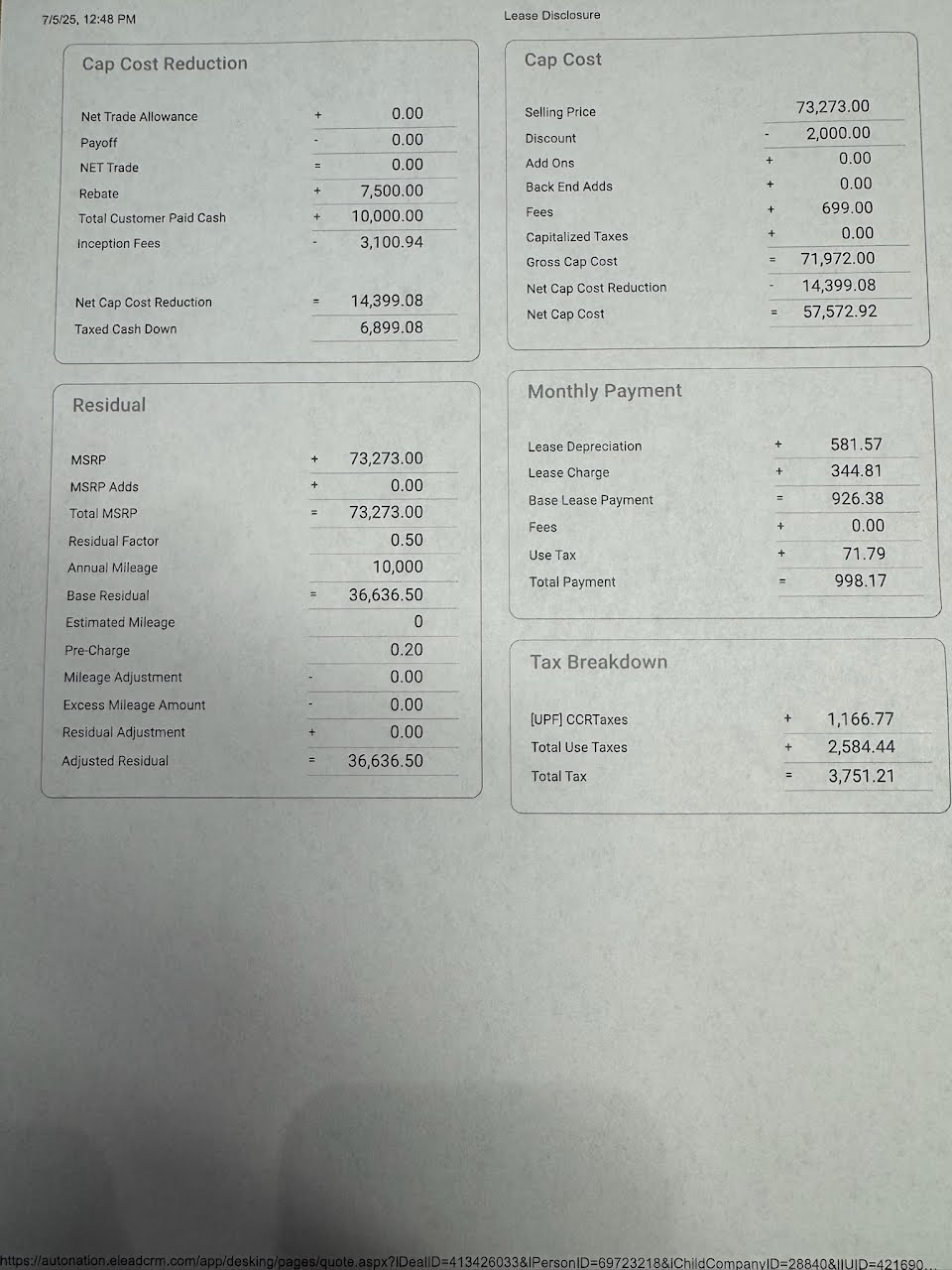

Here’s one. MF is 0.00366
Lease it and make sure the value holds up (likely not) before you buy it. The option to be able to put the vehicle back to VW is worth a ton.
I mean yeah just look at the residual. Thank you for looking out for me though!
Not for $1000/mo with $10k das
