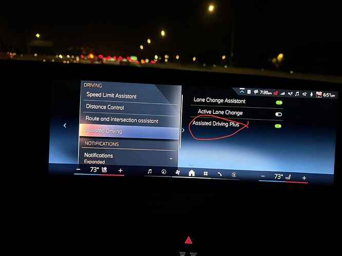

Has anyone else had issues getting hands-free highway assist to work (Drive Assist Plus).
I’ve gone through all the troubleshooting steps; Reboot, reset, seat belts, no sunglasses, steering wheel adjustments, checked settings, etc etc.
I drive on the 5 and 805 freeway in California, so it should absolutely be an option since the car is spec’ed with Premium Package and DAPP
But whenever I try to switch mode, the third option all the way to the right (Assisted Drive Plus) just doesn’t show up.
What model year?
Assist plus turned on in Driving settings?
Model year 2025.
And yes, I’ve turned it on and off. And reset the car a few times. Still not showing.
Is it a software glitch that needs service?
Those roads show up green on the BMW nav ?
if
So, then maybe an error somewhere
I heard December of this year.
It’s very straightforward to activate. But I’m wondering if your car actually has the Driver’s Assistant Professional Package. It’s a $3,200 option to most of the cars the dealer lots did not include this option. Is it possible that you have the standard ā€œPlusā€ package and not the ā€œProfessionalā€ option?
Very strange. You certainly have all the required features. It should be so easy to activate. You just let go of the wheel and will automatically activate.
Do you mind posting on one of the BMW iX dedicated forums? There are lots of folks there than can walk you through the steps:
https://bmwi.bimmerpost.com/forums/forumdisplay.php?f=923
Also make sure this item called assisted driving plus is selected in your driving menu otherwise that feature will be disabled. See picture attached.
@brandrup12 any luck so far?
Took it to service. They recalibrated the cameras and it now works. :+1:t2:
