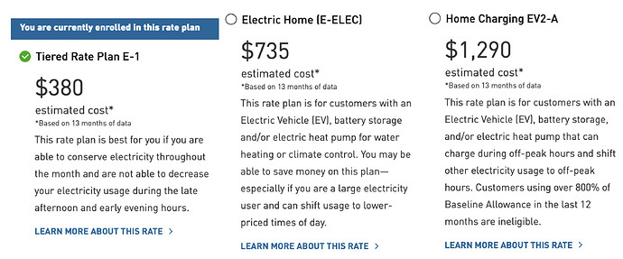

I think most electric companies in California have EV plans, where night charging is super cheap. I’m on SDG&E TOU-EV5 and from 12-6am weekdays and 12a-2p weekends, electricity is like 0.15/kwh. You’d be a fool to use a standard electric plan here with home charging.
This is 100% dependent on if you have solar (with batteries and what NEM you are on) and if you need to charge your EV every night.
TOU/EV may actually be more expensive for some people.
Not necessarily. May not work for you but works for some people.

The only situation I can think of where you wouldn’t sign up, is if your charging is a very small percentage of your overall electricity usage. Since the regular time rates are a bit higher.
I only charge my truck like once per week on average. Combine with shifting some of the heavier electric usage to cheap hours (delayed start dishwasher, washer and dryer), I’m basically paying the same as I did last year without an EV.
The NEM 2.0 helps, as even my little 2 kw solar array is generating that sweet 0.60/kwh nectar. But it’s not much higher than the regular plan rate of ~0.50/kwh.
If you have south-facing(or even worse east-facing) solar and are grandfathered into a non-TOU rate plan, that’s a scenario where you wouldn’t want to give that plan up for an EV-TOU plan that gives you cheap rates overnight. In that scenario you want your electric rate to be highest during the hours of peak solar production which are generally going to be 10am - 2pm(or earlier if east-facing).
There are far more scenarios than what you listed where you would not sign up for a TOU or EV plan with cheaper overnight charging, but as you noted your use must be low with a small solar array and NEM 2.0 for your rates. SDG&E, PG&E and SCE all have different rate structures but they are similar. This guy knows it:
One common example is If you have a large and all-electric house, a few EVs, a much larger solar array than 2kw and NEM 1.0, then your rate choices look much different than yours when you look at E1 vs. TOU and EV - for example:
Yeah, lots of misinformation and assumptions out there about solar, EVs and pretty much everything else! Always be very careful what internet “advice” you are following on someone’s single use case applying to every other situation out there without accounting for variables and your own issues.
